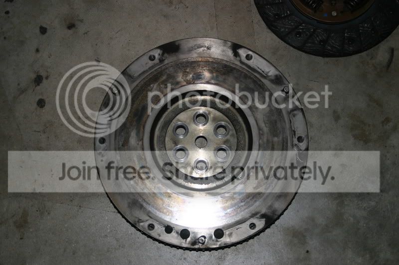

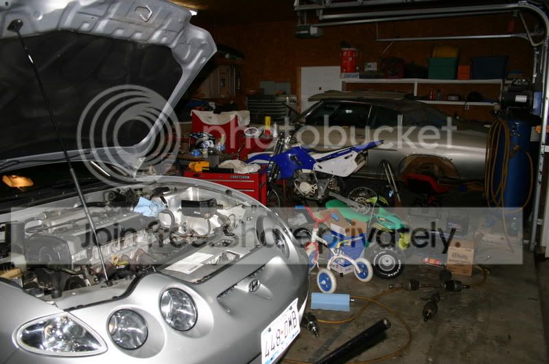

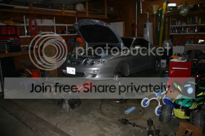

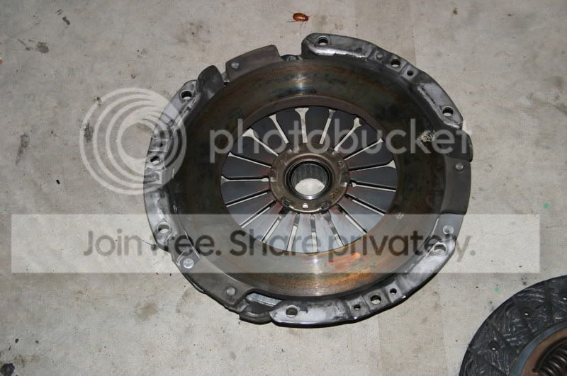

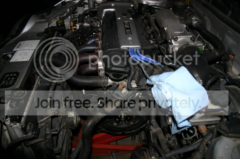

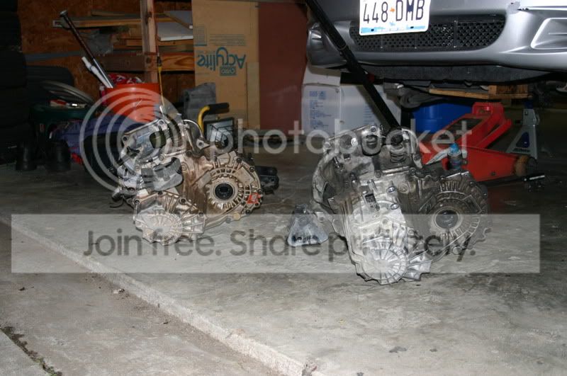

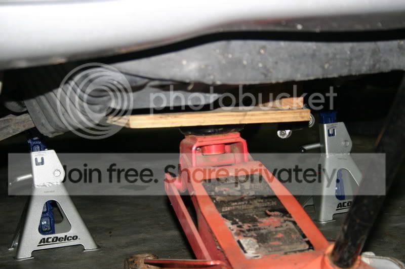

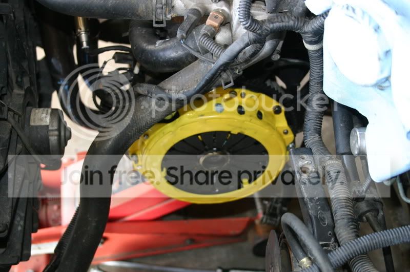

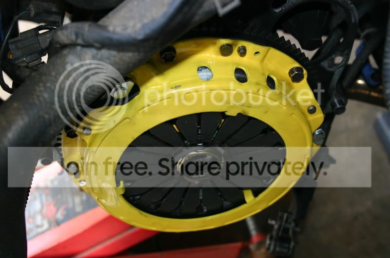

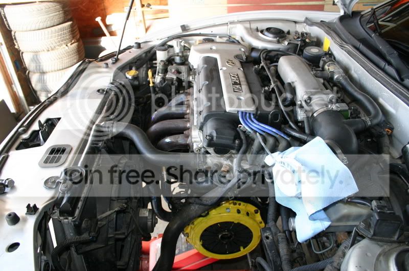

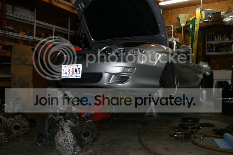

Update! Got it off BY MYSELF without a problem. Also did it in about 2 and half hours(half way there!). Here are some more pics.
Can you say hot spots!?!? ^^^^
Here too! ^^^^

Sorry I dont have any more pics. It was kinda hard with just me. From start to finish took about 30 hours. And remember that is only me working on it. The transmission is awesome. No grinding and is super smooth. Redline seems to be working good so far. The cluth has some expected chatter. Remember is pretty much a race clutch. Flywheel is awesome! Revs so quick in neutral. When the clutch breaks in I will post here again. If you can source a beta 2 tranny do it! Must swap over current mounts. It just takes minimal grind on the rear tranny mount to bolt on correctly. Other than that its a direct swap/bolt on.
