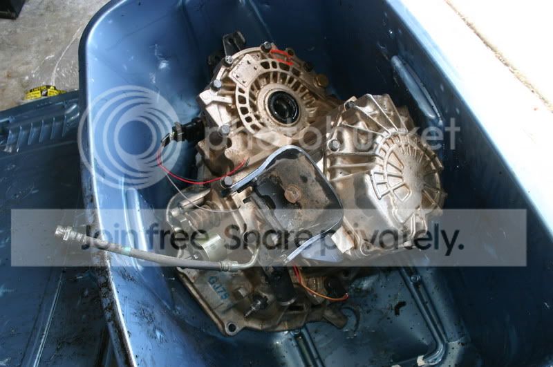

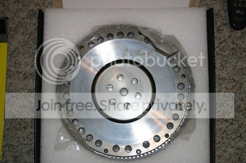

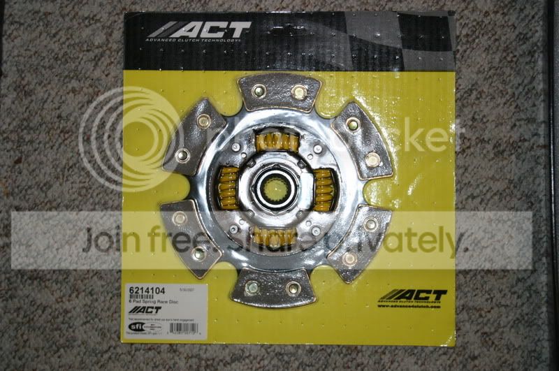

So I decided to bite the bullet and aquire a Beta II Tranny. Its from an 2004 XD with 28k miles on it. I also decided to get an ACT Clutch Kit and Chromoly Flywheel. This will be the project for the new few days. I have done two clutches myself so I know all the little problems that arise. I just need to get some Redline MT-90 and new seals and she will be ready to go in. Also I need to find a grinder or bits for my dremel. Here are some pics. I will be taking alot throught the process just for reference and for anyone else that might need them.

awesome!! def. take alot of pics and maybe do a little write up. I'm planning on doing this my self. I also have an ACT clutch kit and chrome-moly flywheel. Although my six puck clutch doesnt have any springs, i wasnt able to find any with springs 02.gif I'll have a harsh engagement >
Old Jun 13, 2007 | 07:01 PM
LNheart sent your stuff back, and get it from prostreet online, and get the sprung hub, you dont wanna put that un sprung one in your car..
www.prostreetonline.com thats where i got mine from..
good deal landshark, you will like that setup, same one i have, ACT 6 puck sprung clutch, HD PP, beta II transmission, and chromoly flywheel. love the feel and the engagement.

^^^^ I did a search on Prostreet and i didnt see any sprung 6 puck clutches discs alone or in a kit. They all say 4 puck race disc or 6 puck race disk which is what i have right now.... Thanks anyway SOCKS.

$320.20 shipped. Part # HY1-HDG6 Its special order so I called and just ordered it over the phone.

Well, i cant return my kit now since it's past 30 days. I'll just have to contact Prostreet to check if they can get me a sprung six puck clutch disc. I guess it'll cost me 100 shipped >

I have heard the gears are a tad longer for the beta 2 and it takes minimal grinding (as in 1mm) to get it to fit correctly. Im not sure where exactly. I will find out when I get there but other than that it should bolt right up.
