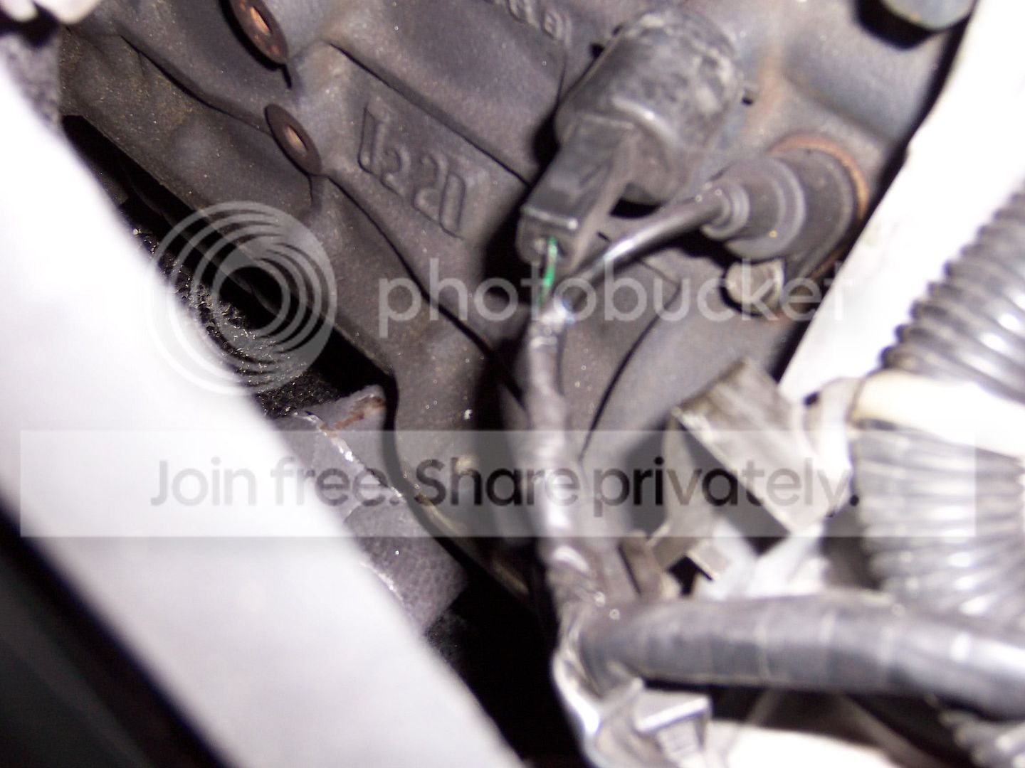

My 01 2.0 has the CPS vertical at 12 o clock. .....
Old Feb 24, 2009 | 04:40 PM
here's one for you,sensor at 6 o'clock position
J<sub>2</sub> 2.0
