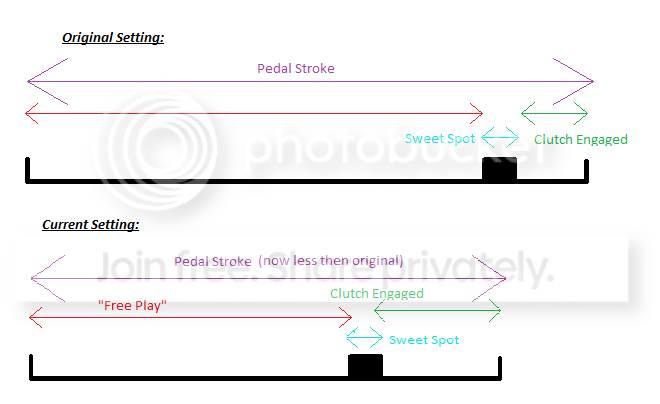

^ yea i understand that part but thats not the part i want to change:
here i'll make a "timeline" so-to-speak...
i want my pedal stroke to have more dsistance after it engages, but its curently at the max possible, because the pedal is not expanding to where it used to now, coz i had to push that bolt attachment lower, now the peda is trying to go as par as possible, but the cluthc line isnt alloing it to, it extended all the way, and not hittig the point it used to hit..
does this clarify? lol

Wow, free play should only be a tiny bit of the entire stroke, something is definitely weird there, maybe you need to bleed your clutch or something?
