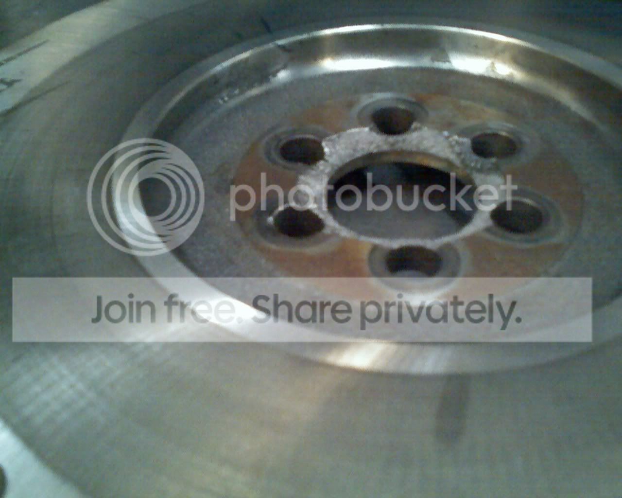

Ok, I found out what the problem was. It turns out my buddy torqued my flywheel to about 400Lbs/Ft with a impact wrench.
That must be a first. Turns out the TOB was fine. Good idea with that though. I appreciate it Jay-M.
