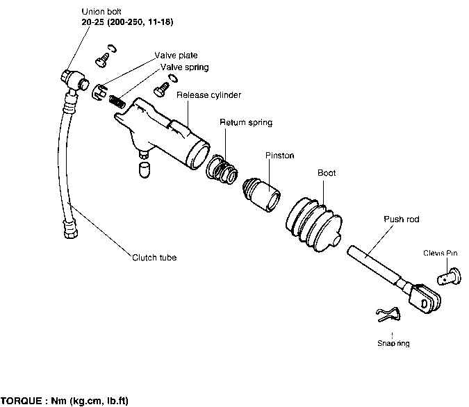

I'm assuming this is removing the valve spring in the picture below? And what's the "shrader" thing that pops out, would that be the valve plate?

Both the valve plate and the valve spring should be removed.
Bleeding is just like bleeding brakes. Connect a see-through hose to the bleeding screw; have someone push the clutch, untighten screw until liquid starts coming out, tighten back when it slows down. Pump the pedal a couple times, and then repeat the whole thing until only liquid with no air bubbles comes out.

QUOTE (StrikeEagle @ Oct 18 2007, 08:02 PM)
When the clutch is pressed, won't there be pressure causing the fluid to squirt out, or should it be slow and mostly air?
It's going to be slow because untightening the bleeding screw a little probably gives a TINY opening for fluid/air to come out. You only turn it a little, until it starts to flow slowly.
You are going to have to drain ALL the fluid, since you will be disconnecting the line from the cylinder (sure, you could clamp the line or something, but why bother, that liquid could use some changing anyway). But it's a very small tank, you just need some DOT 3 or 4 brake fluid, pick up a small bottle, it's prolly a good idea to have some handy anyway.
I did it like this:
1) use a vise grip to unfreeze the rusted to hell bleed screw after seriously rounding it with a wrench (rounding part optional lol)
2) attach a hose to the bleed screw, and to some bottle or something
3) untighten the bleed screw, drain all the fluid
4) tighten it back
5) remove the banjo fitting on the fluid line
6) use a magnetic tool to grab the valve plate and spring
7) install the banjo fitting back
8) fill the clutch fluid tank with DOT 3 brake fluid
9) do the bleed procedure as I described it above. During this procedure, keep an eye on the fluid in the tank, and add more fluid when the fluid level gets too low.
