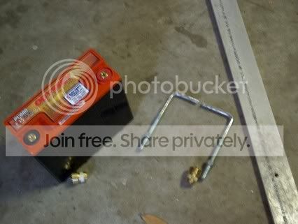

Supplies: oddessy pc 680 battery, weighs 15 lbs about, make sure to get the automative terminals as an option
some allumium, about 2 by 9 inches, i cut it 9 and a half, but 9 would be better because of the extra lenght created by the 9.5"
mothers allumium and mag pollish
i cant describe this really, in the pic, like a square cut off one one side and threads on the things sticking out
regular tools around the garage, such as allen wrench, socket set, wrenches

1 cut the 3 side thing so it is in two hooks
2 cut the allummum to the proper size
3 drill holes in it so you can put the long sides of the hooks through allumum, dont drill so the whole bit goes through, I think you have a tranny down there smile.gif so just use common sense

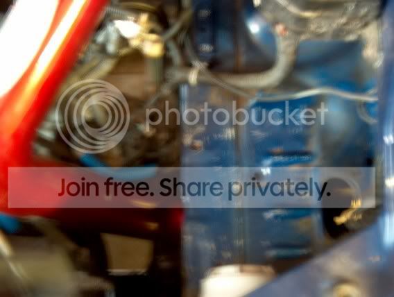

a visual where i put it, where the old battery was
4 drill holes in the car so you can put the hook side through, remember measure twice and cut once lmao.gif , you dont want a million holes there

when you are all done it should look like this
any questions just ask fing02.gif , and good luck
sorry 4 the blurriness, i couldnt hold still, dark out and not enough batt to use flash
