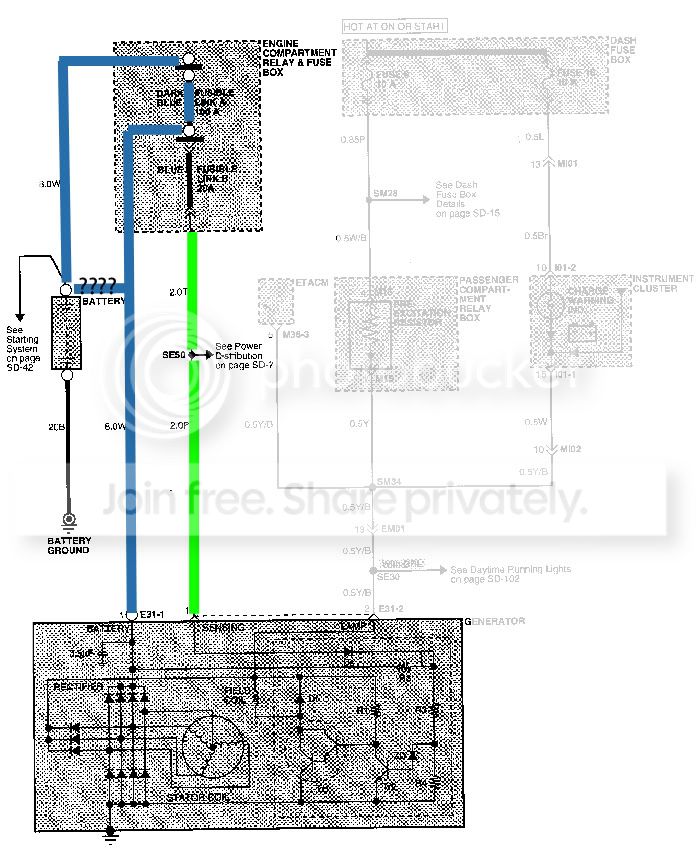

I have not done the power upgrade yet because I have no idea what it will do to the sense line. The resistance of the copper wire may have an effect on the sense line. I really don't know what it does or why it goes all the way out to the fuse box before returning back to the alternator. It would be safest to run it all to the screw on the corner of the fuse box.
I just realized that the entire purpose of the generator circuit as drawn here, is simply for turning on and off the check engine light. However, there may be more to that sense line then what is drawn
