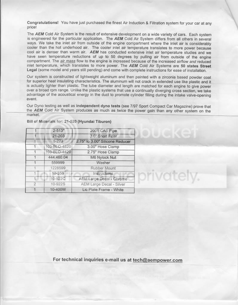

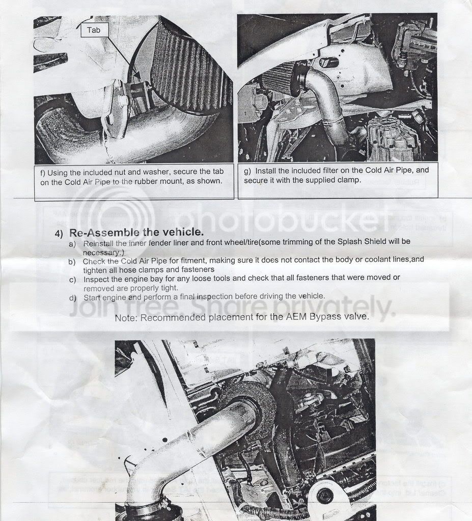

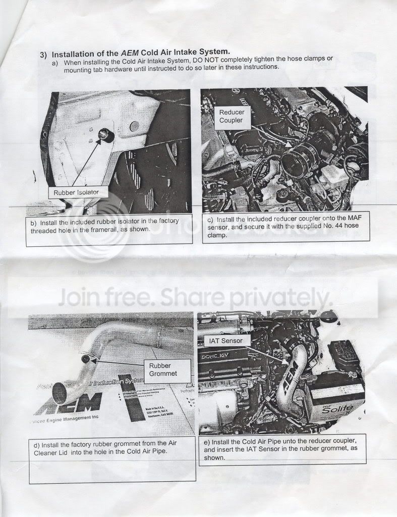

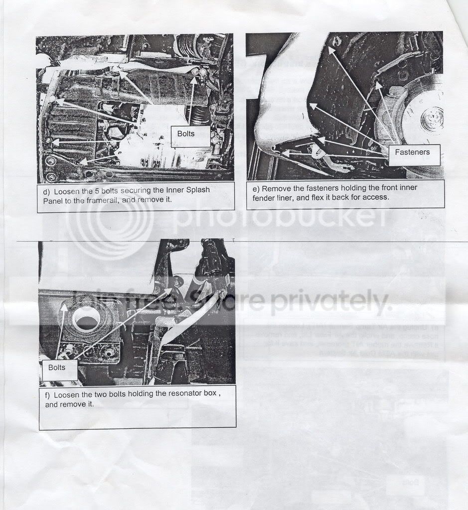

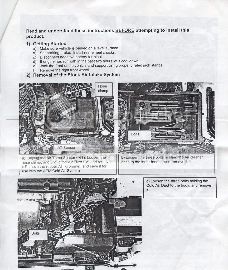

Okay, I got a scanner and am doing this for a bunch of stuff so folks stop asking how to do one or the other.
Back when it was stock, and I still had a "Solite" battery. lol.. wow that seems so long ago.

I've installed mine yesterday.
The only problem i encounterd was that i've got a carbon filter where the AEM filter is supposed to go. So i had to replace this.
This was not mentioned in the manual, but i think it only apply's to european cars.
Other than that, i works fine and sounds great.
