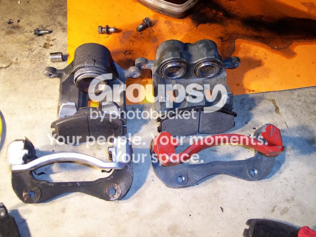

this is what ive come up with...
the size of the sonata rotors WITH ABS are 11.15 or something close to that. about an inch bigger diameter than ours.
same size as the v6 gk, and xg350, except the sonata ones have a 4 bolt pattern.
now, we can upgrade to the bigger single piston v6 caliper with sonata rotors, and only need the 2004 sonata w/ ABS rotors, v6 tib calipers w/ mounting brackets, and new crush washers and other washers here and there(like the one between the line and the caliper...IMPORTANT).
but, the xg350 calipers use the same mounting locations as the v6 tib calipers. so we should be able to use them. you will need the new caliper bracket fromt he xg350 though. which makes me think the pads arent the same.
im still trying to confirm this stuff. searching through newtib.com is a pain though. im definately gonna give it a try, and post up a DIY if the stuff works. im thinking we made need a new master cylinder off of maybe a v6 tib or something, but who knows.
im in the process of being the guinea pig for this one. laugh.gif:

I am definatly watching you on this, Tibby01. Question is though, would you really need to use the XG bracket? It seems to me that as long as the caliper bolted to the bracket, you could use whatever pad fits it. I do not think the Caliper itself really minds what size or shape pad you use (within reason) as long as the pistons contact compleatly with the back of the pad.

i was wondering about that same question, but it seems like maybe the actual caliper has slightly different mounting locations. there is a DIY on newtib.com, that says you need the xg calipers. im sure that whoever wrote it would have tested their v6tib caliper brackets with the xg calipers, but i guess you never know.
they do look very similiar though. might be that the distance between the xg mounting spots on the caliper are a little wider, to accomodate for the two pistons....
