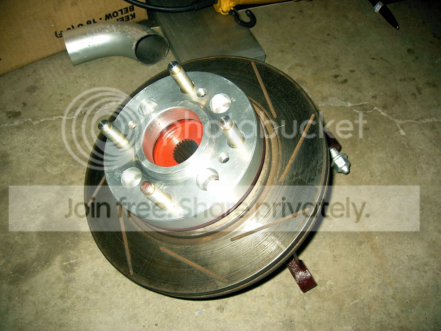

Keep in mind I used to work at a machine shop and have access to 3 my old man owns. Anyhow, I will be running bigger wheels next year and need these now so I can finish the suspension/brakes/and fenders while I'm at it.
Now there are spacers that are made for us all over ebay or kspec etc but I had a certain standard in mind.
I'll share:
I wanted these out of 6061 T6 aircraft aluminum.
I did not want to use hub centric rings for my wheels which I needed. I wanted to make everything once piece which I did.
I used ARP Chromoly Wheel studs, which are 2.7" In length with DOUBLE the size of the knurl so that the spacers are pressed on the knurl itself as well.
The Hub is pressed on the spacer by the knurl and by the centric ring. This guarantees EXACT fit with NO PLAY.
I used 4 hex screws when I need to take the spacers off. As I tighten them they press against the hub and pull the spacers off.
Plus the new hub centric lip also slides into the wheel EXACTLY with only 1.5 thou of play. ( I wanted to make sure the wheel sat on the hub centric ring perfectly)
Here are the pics...
Here are the studs with the knurl that the spacer gets pressed into.
A close up
This is the back of the spacers
Front of spacers

Also, I suggest you use ARP wheel studs. I can give you the part # for them. I got their race studs with a huge knurl so I can also press the spacer on it not just the hub. If you use those studs, you have to enlarge the stud holes by 5 thou so you can press these in and also be able to get them off later lol. Btw, these studs are now 1/2 - 20.

polish them jaw marks off on the ID, naughty naughty, J/K.
what is the overal width you end up using if you don't mind me asking? looks like a inch.
