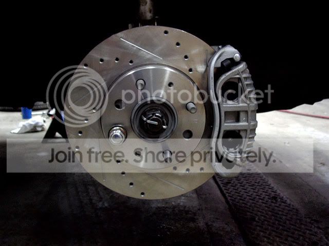

Here's my Snyper drilled/slotted rotors brands new.

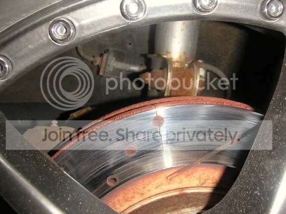

I drove on the street with those for 1 year no problems, but here they are after my first lapping day last summer.

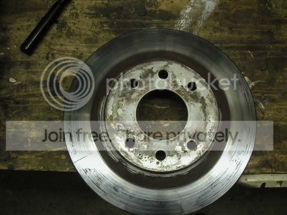

So then I decided to try plain disk, here's the result after 2 months.

These are quality 11" cast iron disk, not the cheap recycled stuff from China most rotors are produced with. In addition I fabricated myself some brake cooling ducks with 3" aluminium dryer hose and I'm only using Hawk Hp+ ferro carbon pads, which are entery level racing pads, not the most hardcore pads out there available for my application. I have this problems with disk craking only in the front, where most of the braking is all done anyways.
All that just to say: for the street, drilled, slotted, drilled/slotted or just plain rotors, pretty much anything is going to do the trick. On the race track, drilled aren't recommended, slotted are to prevent brake fade, but be carefull of the size of the slots. Just plain are most likely to warp quicker. A good idea could be to have the rotors frozen cryogenicly, I haven't tried this option yet, but will soon. wink1.gif

pascoile, you should try sizing some wilwood rotors with wilwood rotor hats to match your calipers. the hats are expensive, but the rotors can be had for very cheap.

Damn pascoile, you must beat the hell out of your brakes!!
Try getting the 12" rotors from the xg 350, I stop damn hard with them and have had no issues for over 6 months, not even the smallest hairline crack.
Although I don't think you can get aluminum calipers over them, you would have to use the cast 2 pistons that are heavy as hell.
Just a suggestion anyway.

a very interesting discussion. Pascoile have you tried using rims that will directing air into your braking system(such corvette rims). http://www.joby.se/corvette/div/corv...els/91zr1.jpeg basically like picture just slots on rim directing air to rotors and such, which i think is done just by switching the wheels to other side. also " where most of the braking is all done anyways" isn't braking mainly on the inner side where pressure of the piston/Piston's are applied(still pressure on outside but caused by the pressure of inner)? working in a shop i typically see inner pads wearing slightly faster than the outer(in both cross dilled what not and OEM).

Pascoile... interesting info! Why do you think everything is cracking? Perhaps it keeps overheating?
