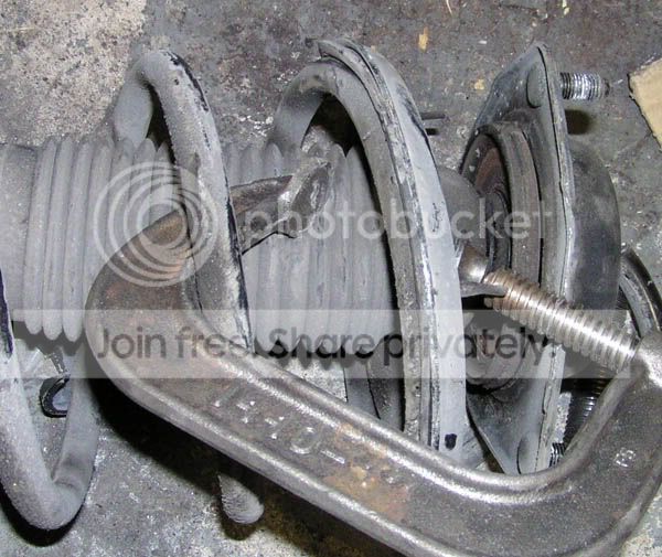

I dropped $50 for a deposit on a spring compressor at Advance Auto Parts in Pflugerville, took it home, and went to town. Because I really needed at least one more spring compressor (see below) and I was using a dremel with a fiberglass-reinforced cut-off wheel, it took just under an hour and a half for each spring, from jack-up to jack-down. So I was working from about 20:00 to 23:00, with a break for brisket sadwiches in the middle.

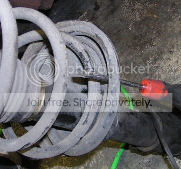

First, I pulled the strut out and marked the cut-line. I wanted the spring to sit smack in the same spot on the perch, so I just made a line even with the stock end of the spring.
Cut carefully. The spring compressor I rented has a goober'd thread on the screw, right where you need another 1/2" of compression, so I couldn't pull all the tension off the spring. That means there is a considerable amount of stored energy in that last coil, and quite some tension on the whole thing. BE FRIKKEN CAREFUL!

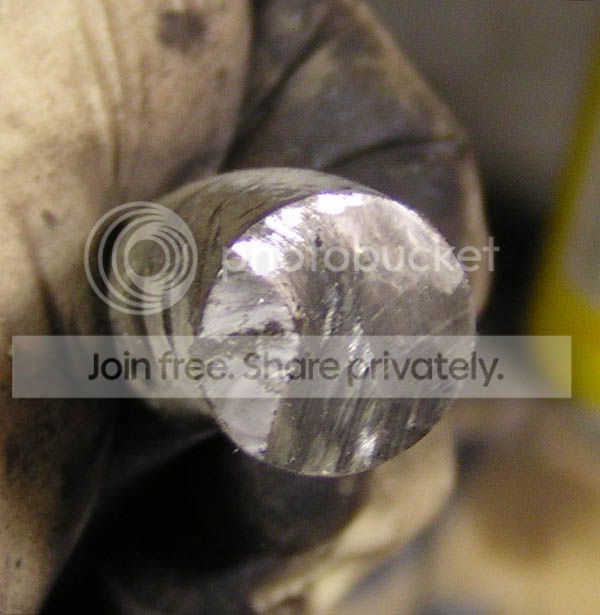

I cut and cut and cut and finally the REALLY nervous part came: it was cut far enough for the stored energy to break the spring with no further cutting.

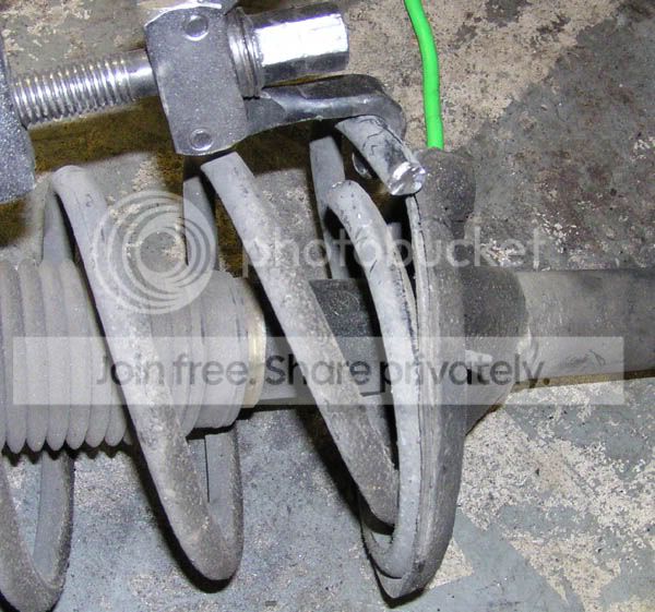

I learned from the first spring what to do on the second. I cut the same cut-line again, so that the spring would have enough of a gap to pop out the side when it popped all the way apart. The first time, I had to struggle with the end of the spring to get it out of the perch to dress it after releasing tension and realizing the end was going to chew through the rubber and steel of the perch. The second one, I cut the thing again and finally it popped:
Do NOT hold the spring near the cut. I was holding the end of the screw on the compressor and it still startled me pretty good when it popped completely apart... the whole strut jumped. The spring can't go anywhere but it can hurt you if you put your finger in its way when it wants to move. Thanks God I didn't even come close to getting hurt during the entire time I was working on this project.

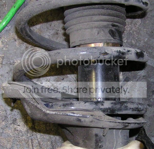

The gray, dull-looking part on the left is what was not yet cut when the spring broke itself.

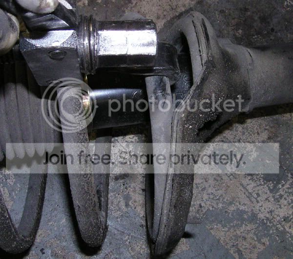

This was necessary, a bit of prying on the cut-off coil. You can't just pull it out off the strut because the gap between the ends is too small. Pry the cutoff coil out so there is an accessible loop and cut it in half. Then pull out the two semicircular cut-off pieces. Some prying on the spring will be required to loosen them enough to pull out. Then you need to use the screwdriver again to pull the spring back into position. I had to release the compressor and rotate the strut some (it rotated by itself during the cutting of the cut-off coil). Release the compressor slowly and pry with the screwdriver to try to get it in position on the perch. You will have difficulty if you don't have the proper spring compressor...

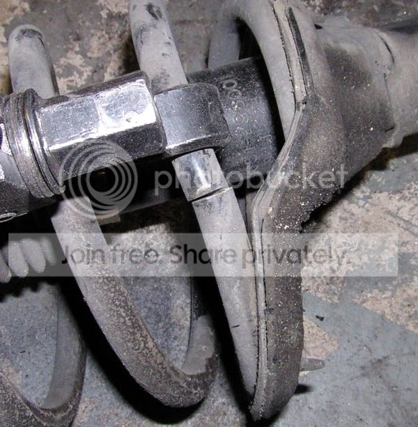

This improvised spring compressor helped pull the spring back into position (make sure it is well-anchored before tightening, lest it pop off and send the clamp flying! )

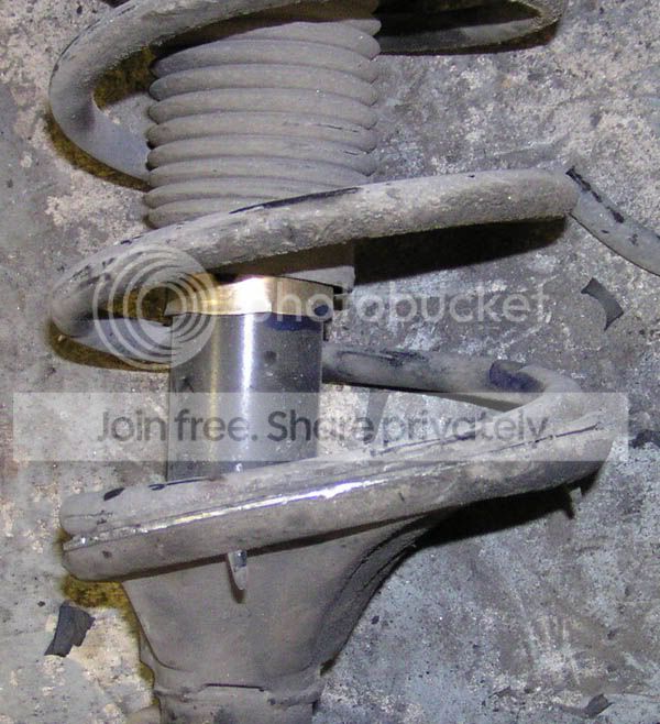

I couldn't get a good shot of the end of the coil after it was dressed (free camera, who's complaining? ). I ended up using a small grinding wheel and rounding off the bottom and sides of the end of the spring so it wouldn't chew up the perch. I then inserted a half-thickness of coolant hose, about 1" x 5/8", under the rubber, to give the end of the spring something to smash into, if it was going to smash through the stock rubber piece.
The end of the spring is pushing into the perch with a good deal of force, even with the strut at maximum extension out of the car. The opposite side coil is even better-seated.
