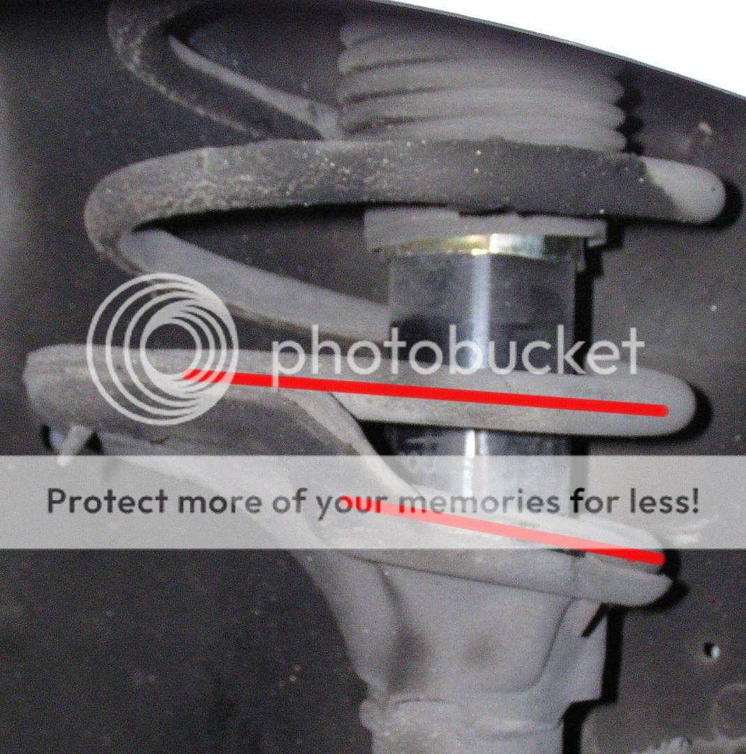

  #27
Stocker's Avatar
TO ALL THE HATERS OUT THERE WHO SAID I SHOULDN'T CUT MY SPRINGS:
Behold:
sorry about the big pic, I forgot to downsize.
The spring is slightly pigtailed. NOT safe to cut. Oh well. By my calculations the front only came up 1/2" to 3/4" anyhow so I'll just ignore it until I feel like paying for some springs. I'm happy to leave it unless someone shows me the spring is not pigtailed when it's removed...anyone want to shoot a stock spring you have laying around, and post a pic real quick?
The rear looks about the same.

Old Nov 15, 2008 | 08:30 PM
  #29
Stocker's Avatar
*I* know you can cut coil springs, just tell that to some of the scaredy-cats around here! nana.gif
The thing is, if you cut a pig-tailed spring, it won't sit right on the perch. Then, when you get a good bottoming-out of the suspension, you'll run the risk of the spring finding a new place to rest, and then your car wants to zig while you are still trying to zag out of a pothole or whatever. Boo.
I repeat myself:
if you have a set of stock springs laying about not mounted on struts, please take a photo of the bottom end and post it up. There is a (very) small chance that the end is compressed by the strut, but I somehow doubt it.
