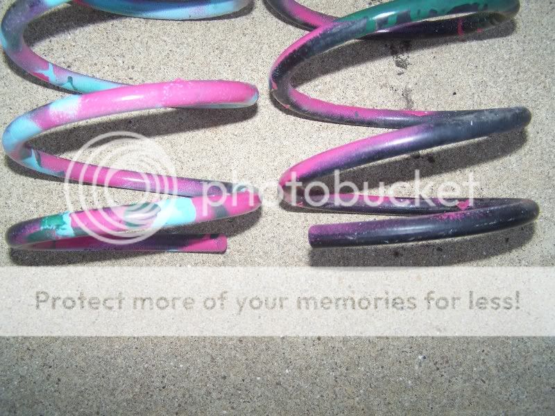

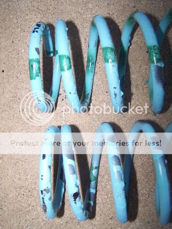

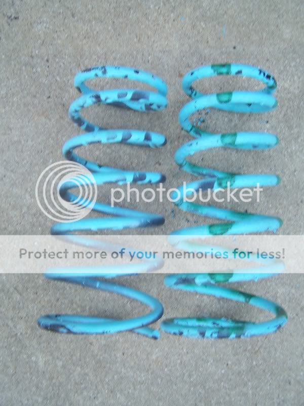

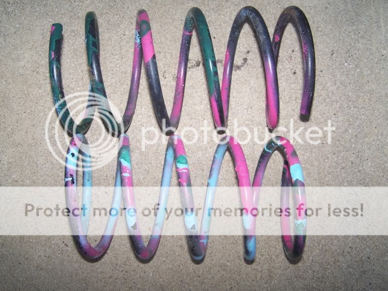

Here are the pics you wanted:
Front:
Rear:

I used to have cut springs and the car did NOT bounce like a honda. YES, it was stiff but it was ok to me. I had 2 coils in the front and 1.5 in the back.
now I have Vogtland springs and KYB struts. but it was because I had a weird rattle and it ended up being my exhaust. LOL

I don't suppose you took a pic of how well they were seated on their perches? Did you ever hit any nasty potholes when they were installed, and they stayed in place?
I might have to still try it after all.

From my experience they stay in place. The incorrect mounting angle bites into the lower strut mount, which means you'll have to replace it frequently or deal with squeeking struts.
Replace the lower strut mount? Boo. It seems like you could dress the bottom of the spring (so it was rounded) when you cut it, and it would bang but not chew on the mount. No? What about reshaping the mount (w/ a hammer) so the angle was more correct.
