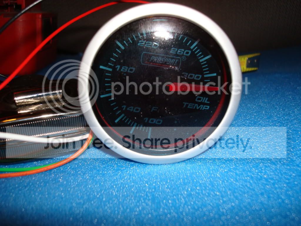

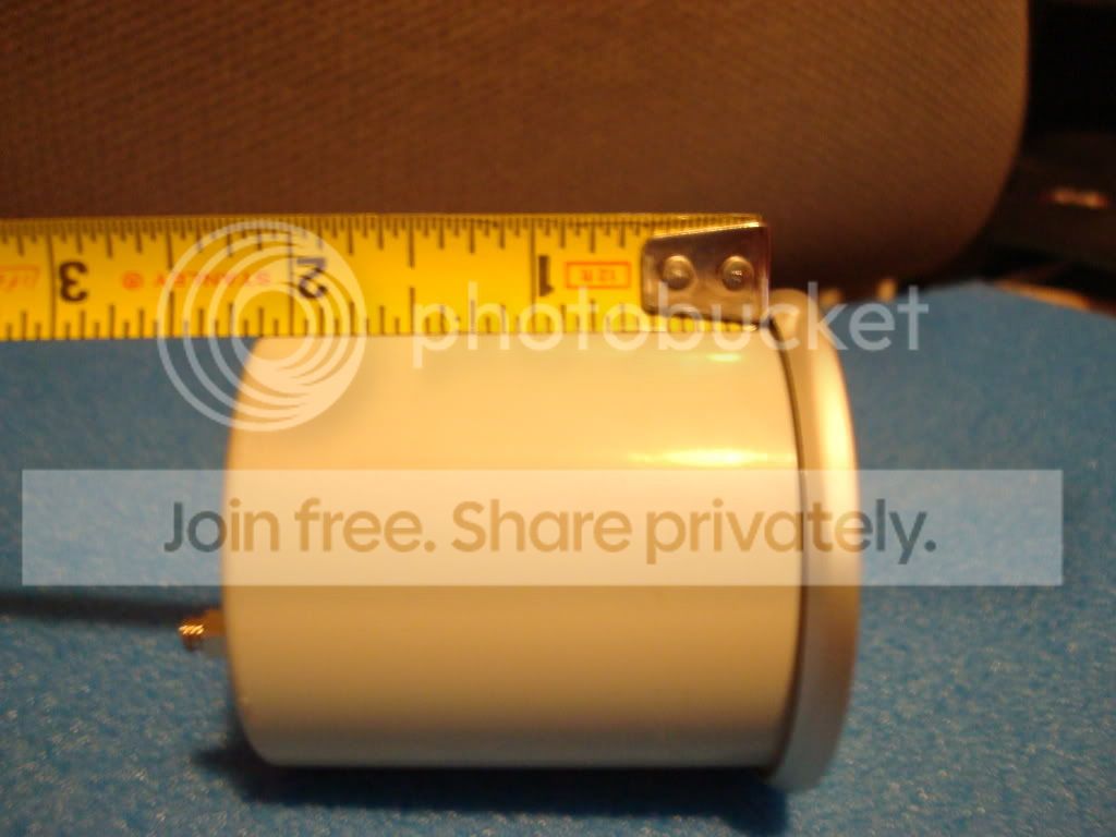

CD...
I was looking at my gauge pillar pod I was going to send to you to use as a mold a long time ago and just realized a few things about it. there are several of us right now that prosport gauges for our cars. these guage housing are rather big and in fact only one of three will fit in the cut holes in my pillar pod right now. measuring from the lip bezel to the rear of the gauge you need 2.25" of clearance and the housing is 2 inches in dia.
I know Ericy has a set of prosport gauges waiting for your pod right now, just thought i would throw out that little tidbit of info so you don't have alot of mad customers .
Lee

I test all the holes with std autometer gauges which are 2 1/16" and
The diameter will be fine as they are both 2 1/16" (52mm) I'll check the distance to make sure the Prosports will fit also though. Can you confirm that the Prosports are 2.25" from the lip to the max end of the gauge ?

sure can bud...here you go...
I know i said 2.25" but i was allowing .125" for some play. these gauges do came with a angled blinder to take the glare away from the sun but i don't know if I will be using them. the bolts on the back are recessed far enough from the edge that they WILL NOT come into play with the O.D.
