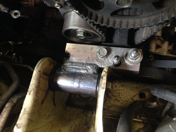

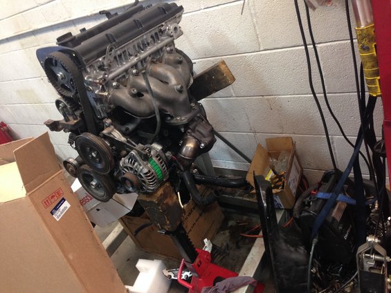

Little back story ....
2001 1.5L 185k miles blew gasket
Tiburon 2.0L with 145k
TUrbo Scoupe Centerforce Dual friction clutch
T04s .48/.50ar turbo
7psi spring
stock LC tranny
GK Tiburon seats/harness bar
WTA intercooler

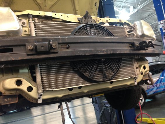

Ford Focus condenser used as Heat Exchanger
modified front crash bar for clearance, re-inforced with Chromoly tube
Megasquirt 1
TO Do list:
-meth injection
-fuel OEM fuel pumps (no Walbro)
-XG injectors
-2004 Kia Optima rotors/RD hubs/GK red calipers/16" wheels
-Batt relocate

That's pretty cool! I like the ingenuity with the brake kit and injectors. Did you research all this or is the knowledge out there somewhere?
What CC are those injectors?
Did you mean to say you're using DUAL oem fuel pumps?

That's badass. I didn't know you could throw Beta's into '01's. That is a pretty build. Ultmate sleeper. You gonna keep it looking stock?

I'm kinda surprised both you guys posting are not aware of these conversions lol. I got all the info from this site?
I did mean to say Dual fuel pumps as the whole build is for fun and on a budget, will be my daily driver.
The XG injectors should be around 300cc, though would be nice to source something bigger from the local scrap yard.
Body will stay stock except I will be cutting holes in the hood to vent all the radiators.
