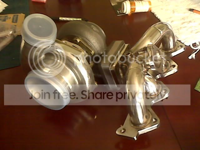

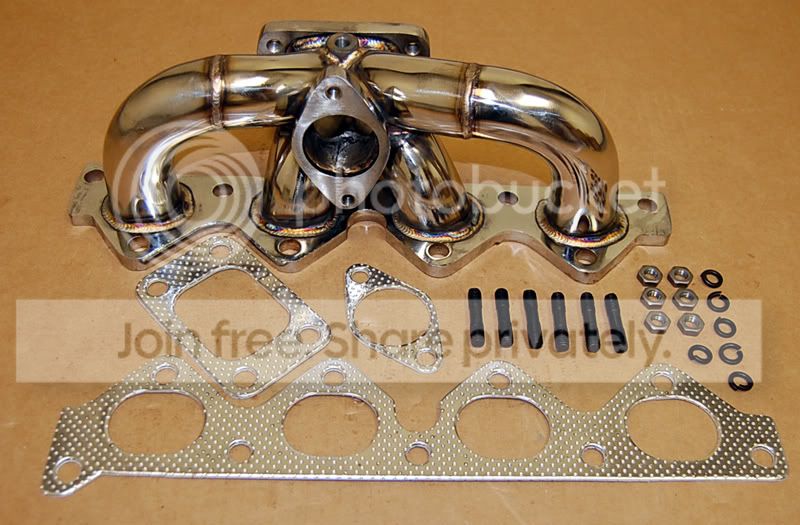

The super 60 turbo is attached to a different turbo manifold, than what your running with your ebay turbo. Which manifold are you going to run with your bigger turbo??

The manifold in my first setup is obx. The one for my next setup is a manifold i got off ebay. Its made by a company named E-Sales Race Distribution. It was only $140. It looks like a good manifold. It should up just as good if not better than the obx.
