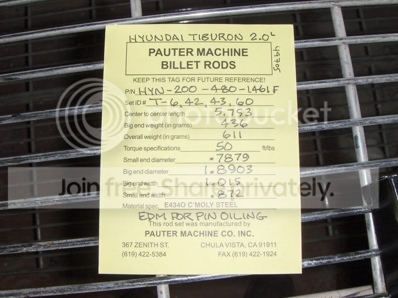

Are these the pauter rods that you guys are using.
(by you guys i mean those of you who are using pauter rods)
http://www.frsport.com/Pauter-HYN-20...a_p_12505.html
Old Dec 9, 2010 | 01:21 PM
03tibe85's Avatar
Joined: Sep 2009
Posts: 576
From: Denver, CO
Vehicle: 2003/Hyundai/Tiburon
Yup, those are the ones I'm running. Be sure to specify the year of your engine when you order as the rod journal chamfer angle is different between the Beta 1 and 2 engines.

The same as I use.,I also had mine rifle drilled.
