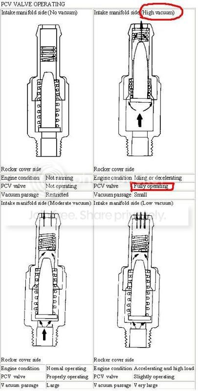

as for the pcv, install it back or get a new one and hook it back to the IM. i believe that it needs to see vacuum in order for it to work properly 100%.
a good working clean pcv valve can resist boost, so you dont have to worry
