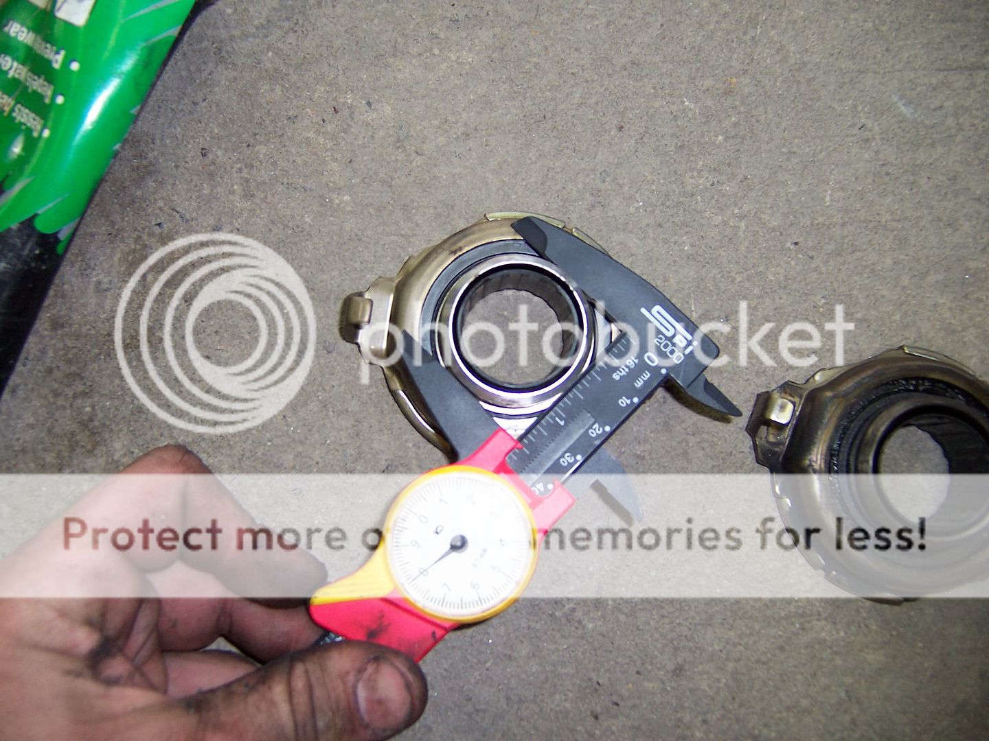

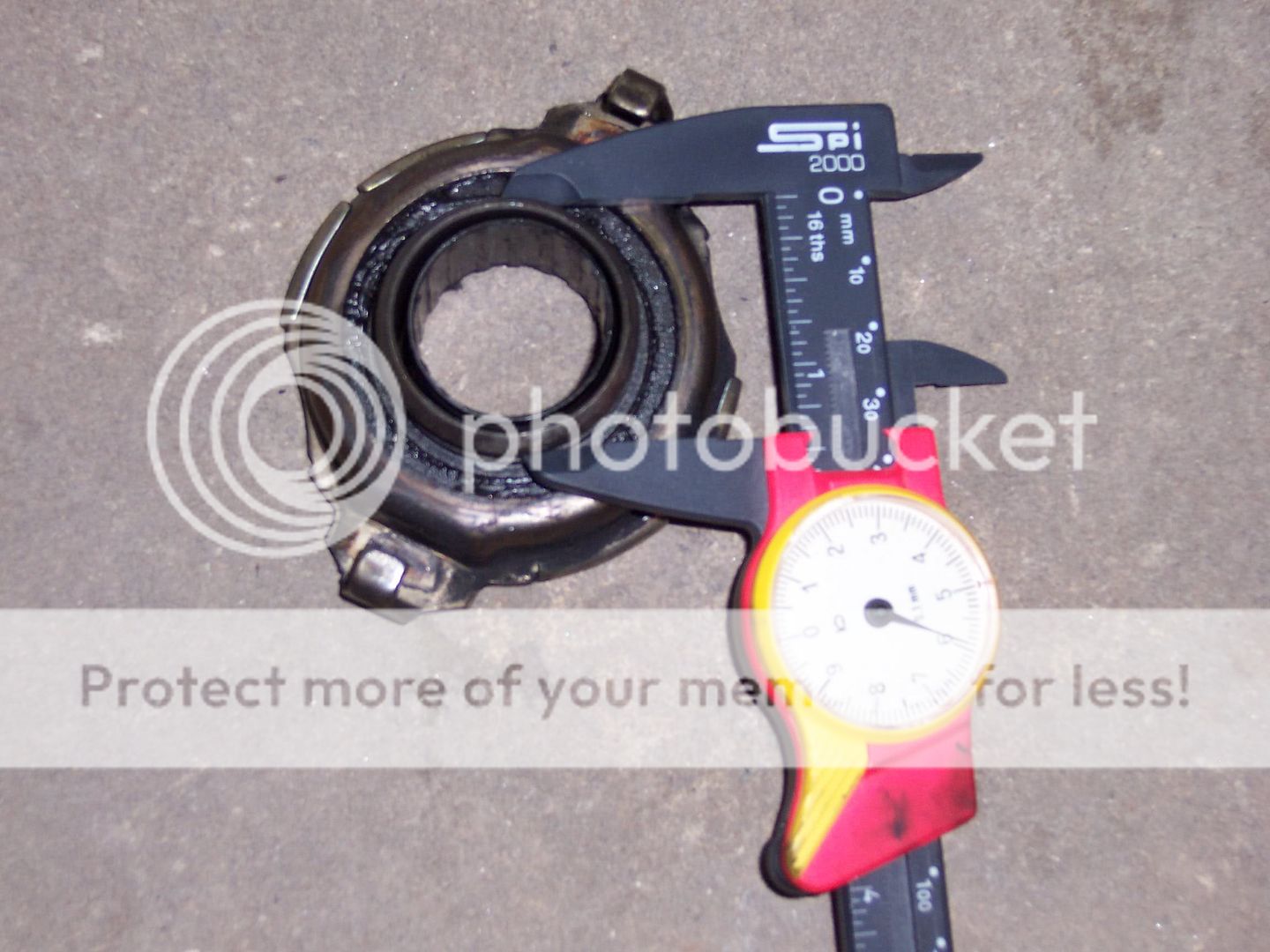

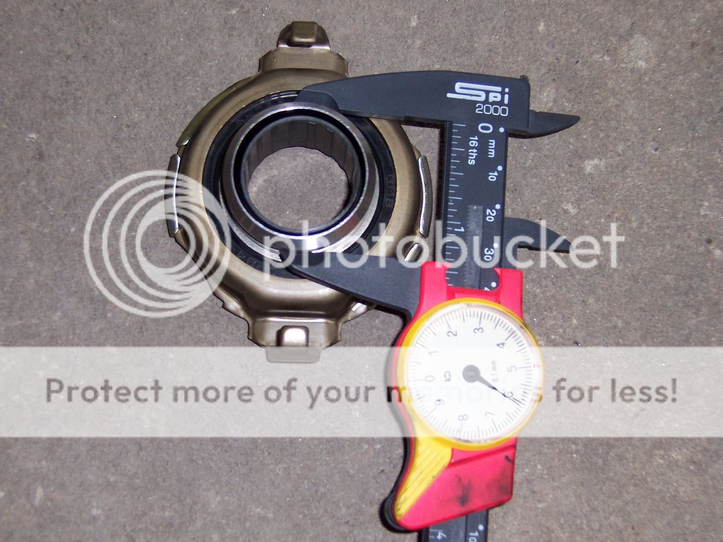

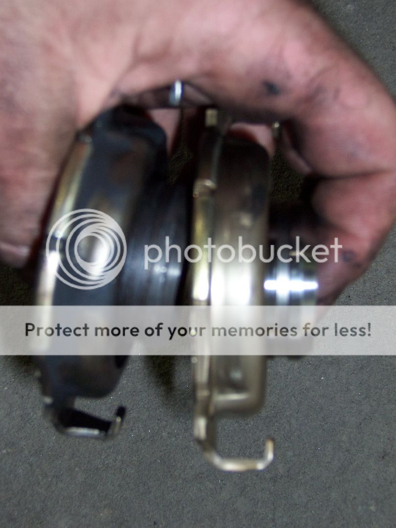

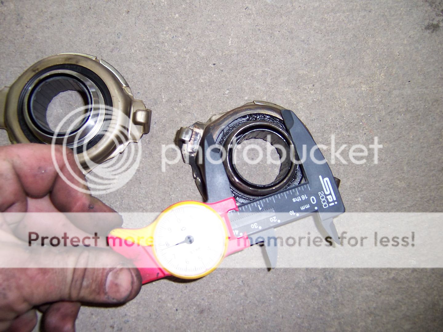

Further research shows that the TOB is mal-manufactured
XTD TOB inner spring diameter:
XTD TOB outter spring retaining diameter:
Perfection Zoom TOB inner spring diameter
Perfection Zoom TOB outter spring retaining diameter
As you can see, in the XTD kit, the spring has more room to wiggle and less of a lip to retain the spring into the groove, so obviously, that must be what was causing it to pop out.

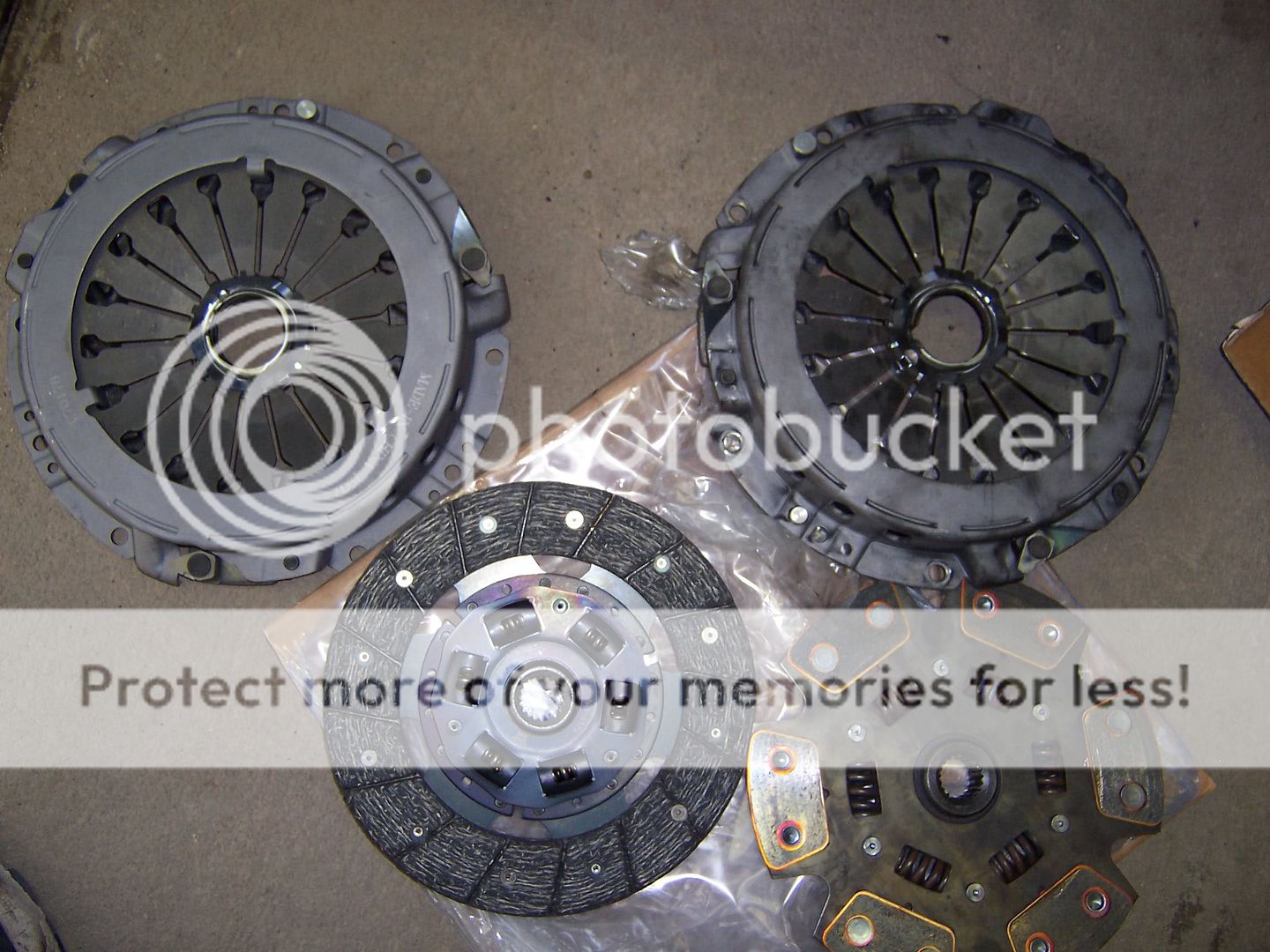

Here you can see the Perfection Zoom pressure plate and organic clutch on the left and the XTD Stage III pressure plate and 6 puc ceramic on the right. Notice the pressure plate is the same.
