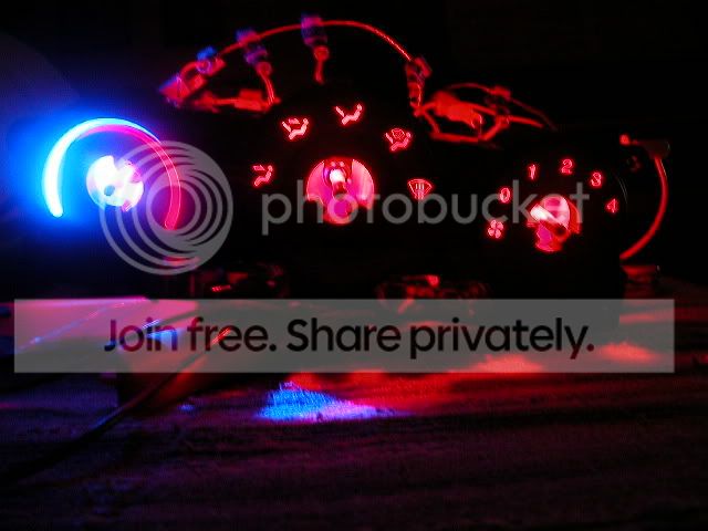

heres a sneak peak tibwrc. all i have to do now is get those dial slits illuminated brightely and it will be on its way to you....
redz, just to double check on what i am sending you...
1. drivers side window switch
2. fog, cruise, rear defrost, and rear wiper switch(wasnt able to get the last one resistored)
3. blue needle kit
is that all?
be careful when you stick the switches back into that little plastic bracket peice. the resistors stick up a TAD of the bottom. i just tried them out in one of the brackets, and with a little bit of persuading, they slide right in. just make sure you dont rip the resistors out. the solder joints are pretty strong though, and i think youll know exactly what to do when you see em.

Looks frantastic mang, and yes, that's all of it for me.
You gonna send me a wiring diagram for that needle kit?
Also, can you tell me what wire I'm gonna have to cut for that one? I'll be really careful with the resistors my friend.
Heh heh...
Also, what did you think of the boots?
You get your soldering iron?

for the rear wiper switch, you will have to cut the green/white wire and crimp the resistor on that wire. the green/white wire is the power wire for the illuminations for every switch.
boots look great, will be putting them in soon.
the needle kit is EASY to install man. a grey power wire and a black ground wire X 3. you know your bomz faces? just hook tthe power and ground wires directly to the power and ground wires for those. INbetween that little box and wherever you tapped into power and ground on the car.
if you need me though, ill definately get on aim and help you out.
