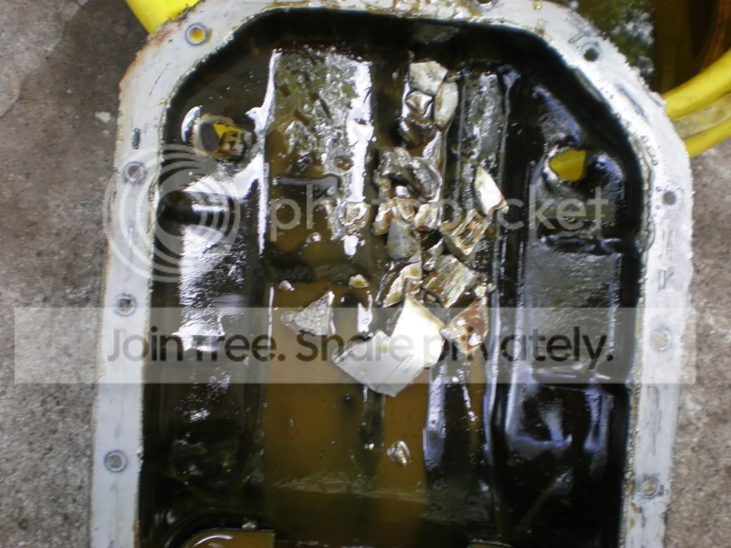

I don't know where to post it so if i put it in the wrong section please move it.
this is the Q & A of my mishap.... LOL
the car currently have 106k + miles, completely stock internals with a compression of 200psi on a cold engine.
the car was idling rich for the past couple of weeks and while under boost at wot it always had a mid 11's AFR with no signs of knock (that i could hear).
the boost was set at around 17psi and it would spike to 20 psi and i let off the gas pedal. still i had a rough tune for up to 25 psi for just in case.... tongue.gif
i currently don't know what kind of power the car was making because i refuse to use my CC to mod my car, much less pay for dyno time. wink1.gif I know its relative of what type of tire you have but i could break them loose on 3rd gear. 006.gif

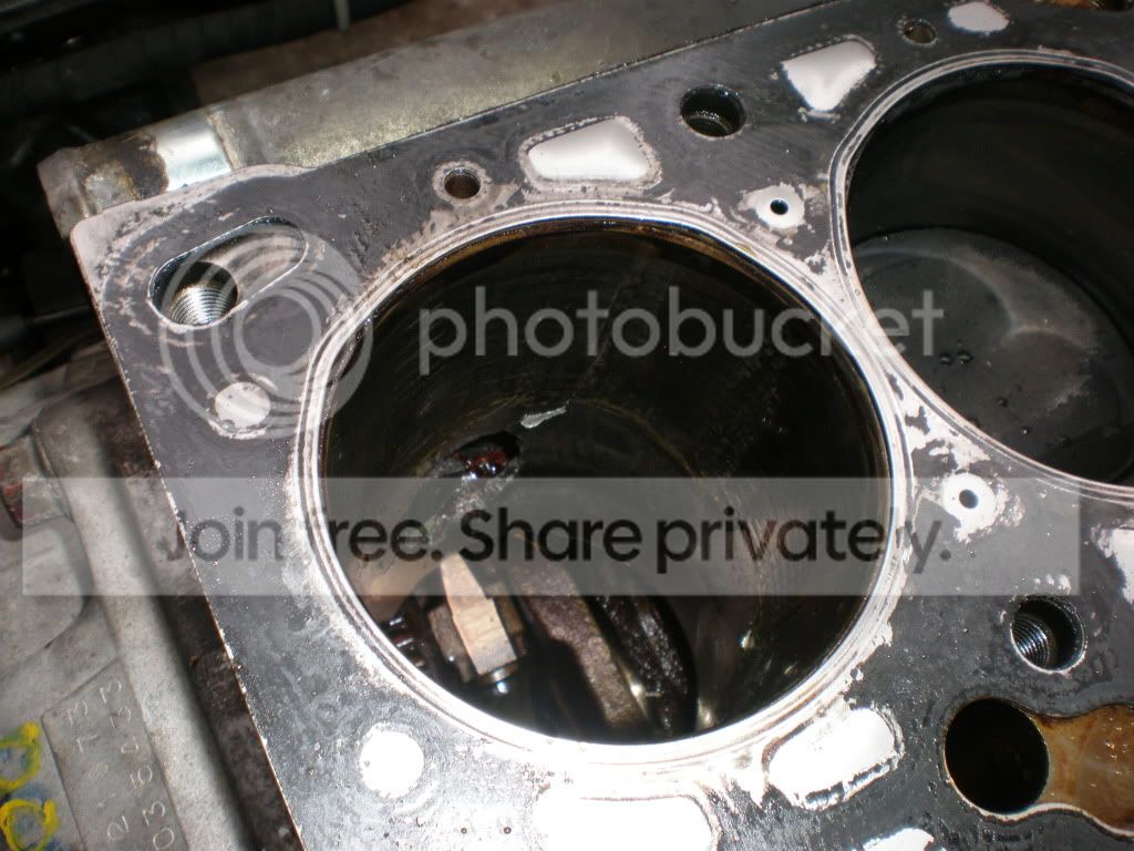

now, i won't know what happened until Friday when i have time to take a good look. for now here are a couple of pics of the only thing i can see.

can't tell what I'm seeing. Something blowed up a little . . .

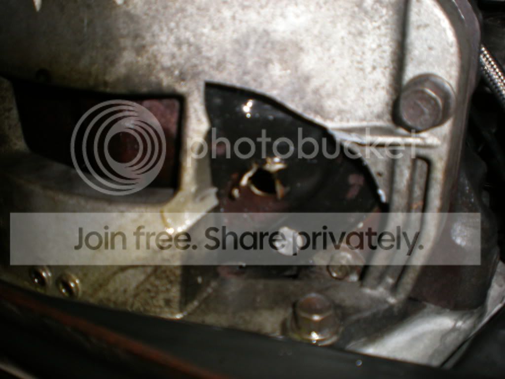

well thats the oil pan and oil pan guard... with a giant piece missing...
That hole looks just the right size for a rod bolt to make...
Ouch.

i just took the oil pan out and the rod of cylinder #4 snapped.
edit:
i thought the pieces on the oil pan was part of the rod but its the piston that shattered.

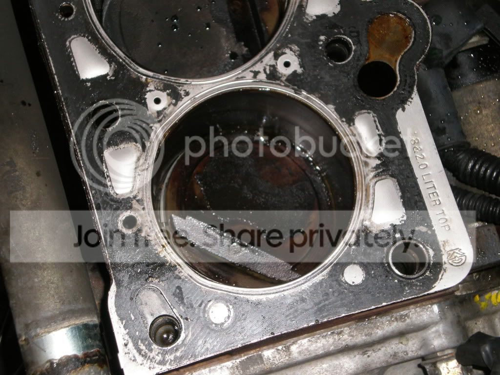

It probably was that the engine under a lot of load. I'm going to pull the cylinder head out and check if the cylinder walls are okay. If so, I will change the pistons and rods.
