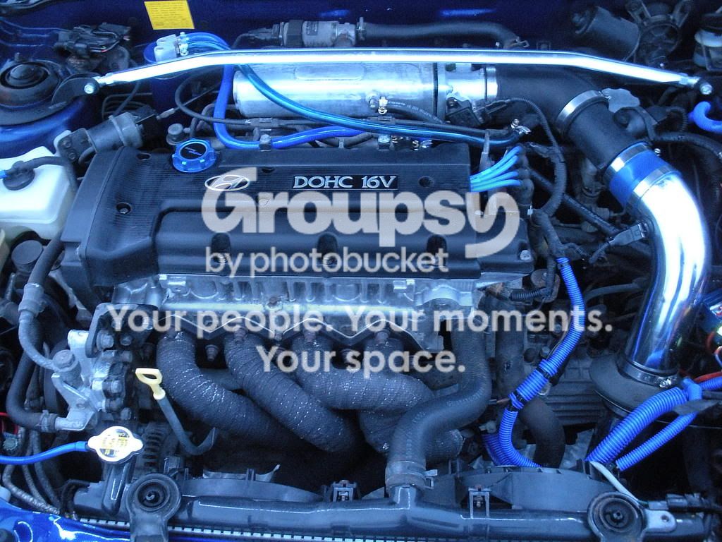

ddude was the first one that got them installed but he had prior front end damage on his car. I was the second and the headers have tons of room. the only problem with them is you have to take off the power steering mount arm off the block to install cause Megan made the flange too damn big. the O2 sensor could've been placed a little higher but it will go in, just doesn't have alot of slack in the wiring.
the only ones i know that are really close are the maintec's. the headers in Red'z cause are really close to the fans and i think you couldn't upgrade to a koyo rad in a rd version of a tib with those headers.

In my case I literally had 3-4" of clearance on the passenger fan, and about 2" on the thicker drivers side fan.
I had it installed at a shop when I had my exhaust put on and they said it went on perfect without any problems.
All-in-all I'm VERY happy with these headers.
