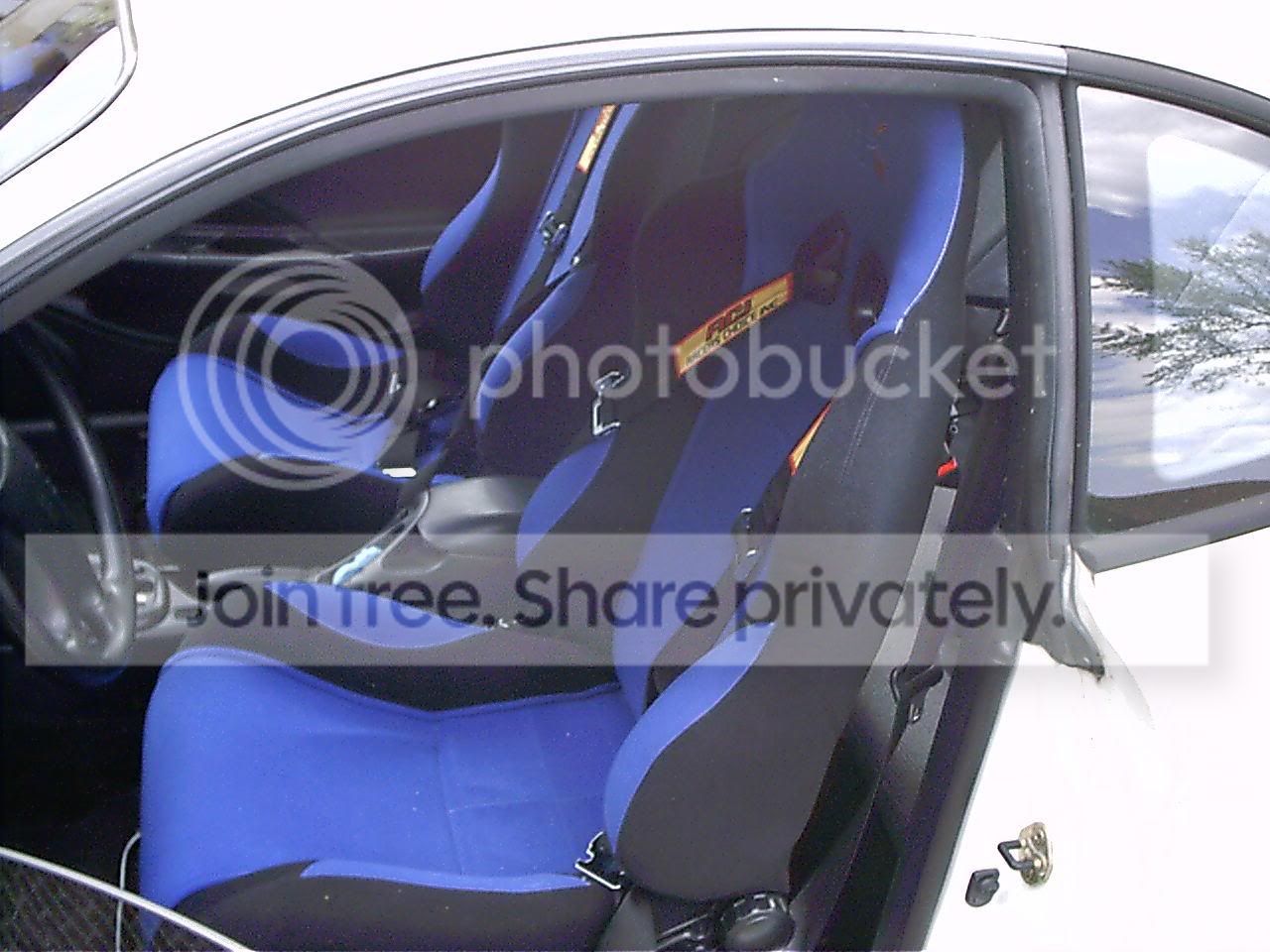

Seat hookup

Seat hookup

hey, wanna make me some of those brackets for my seats? we have the same seats but my brackets are less than perfect (the passenger side is only held down by 3, LOL)
Ok, here's how I did and what I used..
They came on sliders and so I worked out pretty quickly that it would be very easy to tap and bolt into the floorbeam in the front where the stock seats bolted it.
Very very easy, tap cost about $3 and the bolts were cheap.
However once they were bolted down it was clear to see the islands at the back where the stock seats bolted down were miles away from the sliders and the back part of the bucket seat slider was about an inch too high anyways.
After alot of head scratching I hatched my plan.. go to the steel yard (fazzios) and get some 1"x3" box section steel.
If memory serves these were about 17.5 inches accross but dont count me on that smile.gif
So I then used the stock seats to mark the holes and drilled into the 3x1 all the way through.
At which point I cut out sections so that the bolts (the stock seat bolts) could pass through the top layer and bolt the bottom layer down.
Once these beams were fabbed and very sturdy on the floor I then bolted the front bolts down and marked the rear holes through the sliders onto the new beams I had on the floor... remove seat, drill and tap rear holes into the beams and then completely bolt the seat down.. very very solid..
The harnesses are bolted as follows...
The side harness fixtures are in between the stock bolt and the rear fabbed beam and the rear harness points anchor to the rear seatbelt bolts below the rear window.
A bit of a pain because one strap needs to be adjusted slightly longer than the other so that they center ok but after an hour or so of twiddling it all went together well.
What ill do is draw up a diagram of how I did it.. you'll also need a angle grinder with a cut wheel to fab the side parts so that you can get the bolts in smile.gif
