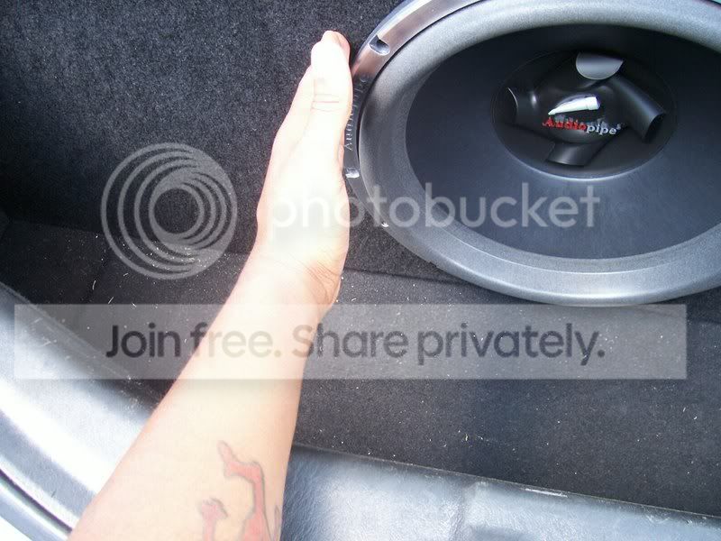

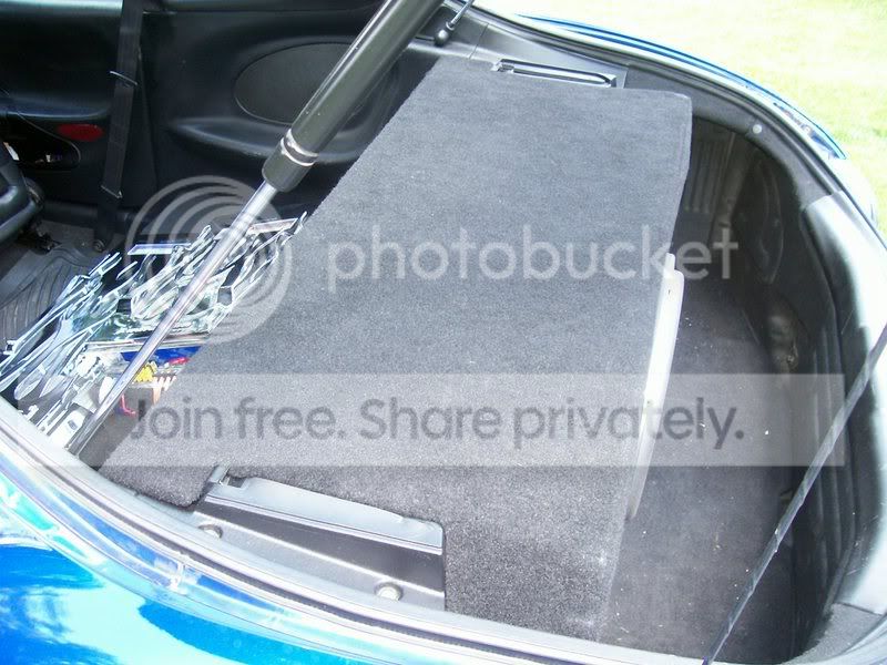

Old Aug 20, 2007 | 10:43 AM
just measured but i couldnt find a tape measure anywhere so i just used a ruler
40widex17.5deepx17ish tall(but yours can be as tall or short as you want to fit your 12's. mine is to fit a 15"
you will get exact measurements across and up its the depth that you need to worry about because that is how much trunk space you have left.
