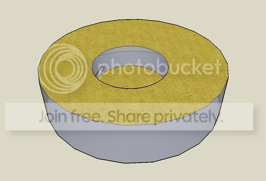

Wrap it in tape and aluminum foil. Plastic wrap won't work. The resin for the fg doesn't stick to the foil very well. I would use mdf for the top because fiberglass would have to be thick so it wouldn't vibrate with the sub.
You could always use mdf for the top and bottom of the enclosure separated with bracing then fg the sides.
Like this: Tan is mdf, grey is fg
It was a real quick drawing but just to give you an idea.

Tib, I like your idea with the two pieces of MDF and FG in between. I'm thinking all FG bottom and a MDF top may be best tho because I could just form the piece over my spare tire and slide it off. Then I could add inside layers and it would slide in perfect and fit on the spare tire rubber blocks. The slight curvature that the bottom would have would probably have it sit a little tighter on the blocks.
