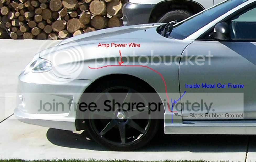

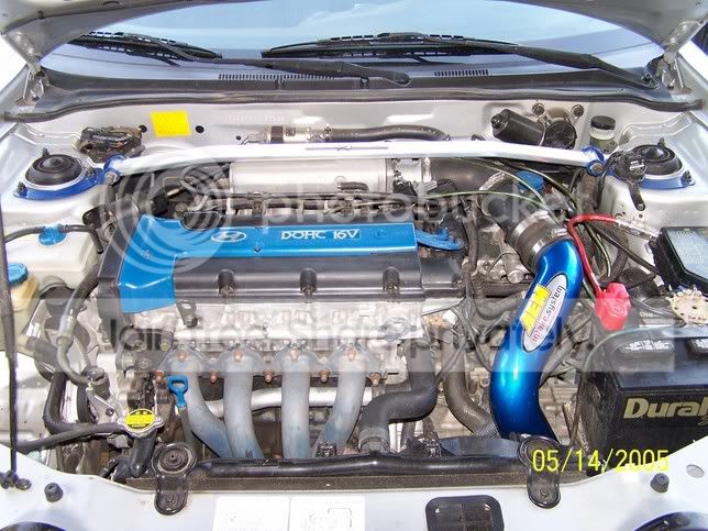

I found the best place you can use to run the Battery wire for the Amp. Bear with me with the photoshop and the directions. I will try to do my best to explain. Sorry for the pics being so big, still having problems with getting them smaller.
As you can see in the second picture I ran the wire around and under the fuse box. There is a opening where you can run it into the side fender just to the right of battery.
Remove the tire and also remove the top and right( as if you are looking at it in the picture) plastic mud guard, or move it out of the way the best you could. You would run the wire inside of the fender just above the top guard then down the right side.
Now for the best thing I found. There is a rubber gromet towards the bottom that you can take out and it is the perfect size for a 4 guage wire. To get the wire inside of the car, move the fuse box that is inside under the dash on the left side and I think you have to move some of the carpet out of the way. You should be able to see the other side of the opening of where the wire will run though.
Just run it through there and down the side of the car in that black plastic liner (not sure what's it called, lol). Then what I did is run it under the back seat and into the trunk.
I hope that helps any, let me know if you have any questions.
good responce.. I am sure people will use your advice..

off topic a bit, but going through the drivers side fender is what i had to do to run my 0/1 gauge. i believe i had to ubolt my fuse box to get it through there also.

firebug21 is right, that grommet is the best place to run cables. I wish I had found it before I drilled the firewall. I did use it to run wire to my door though.
