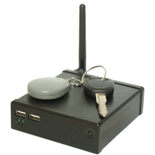

check out this bad mammajama. It's called a Fit-Pc, and it will hook up to your car battery.
e-bay link http://cgi.ebay.com/fit-PC-Slim-XP-miniatu...3QQcmdZViewItem
