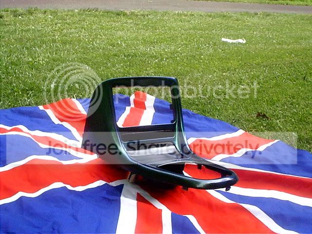

I chopped this up aaages ago to compensate for the 03 infinity DIN from my friends GK.. I love this head unit.. sounds lovely and looks poo, that way noone knows what youre hiding laugh.gif
I chopped out the centre bar and skimmed it to fit perfectly over the HU, so all that was left was some spot putty and filler work and alot of sanding and shaping.. it's about there now smile.gif

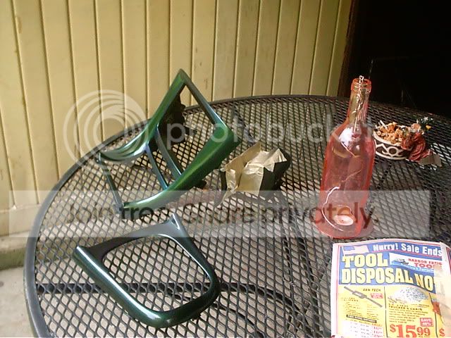

Decided that green to blue HOK kameleon would suit well, I have painted the front bezel of the cup holder and the ash tray face black (repaint with alot of HOK klear) and the surrounds with the kameleon.
The heater knobs will also be done kameleon with red kandy over the light up parts.
Im going to stop there as I dont like the look when all the doors and stuff are done, I might remove the wee airbag switch housing and do that too but thatll be it.
Paint came out amazingly well, it looks a bit milky/misty here because I had literally just painted down the 3rd coat of klear, but it's gone transparent now smile.gif

So here it is all reassembled and ready to go back in (once the reek of fumes has passed laugh.gif )

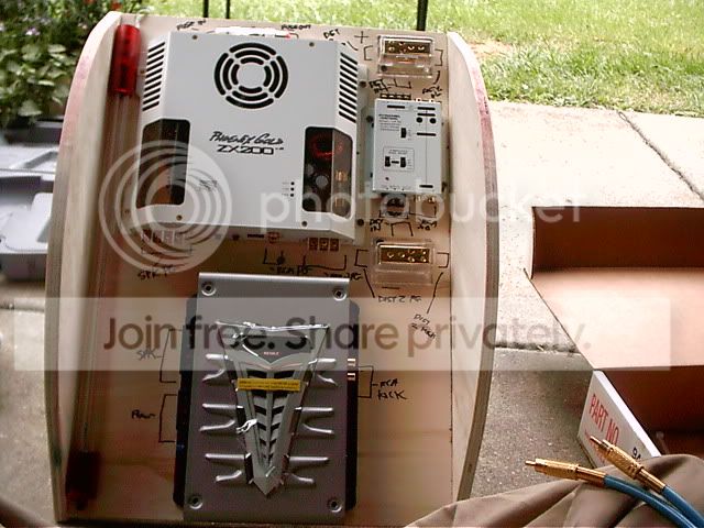

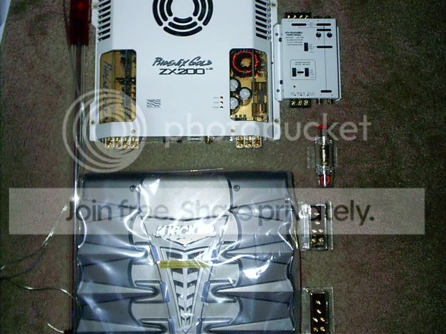

And laid out all the stuff that's going to be on the amp board so I could arrange it all to fit smile.gif

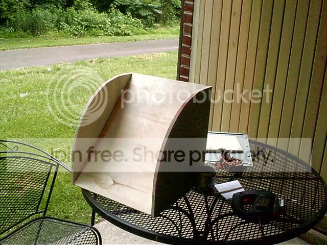

This is it built.. the amp board is detatchable from the centre..
The insides of the part you can see with the board in will be painted kameleon (the inside side viewable areas) and the outsides and edges of the curve will be carpetted.. the amp board is also carptetted.
Then final mock up before I turned the amp board into swiss cheese laugh.gif
And the almost completed amp board... everything is in position but I didnt have any thin rem cable, power cable or ground cable.
I had to move a couple of things post mock as they wouldnt have worked where they were smile.gif

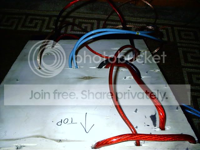

I decided on birch ply because it is lighter and makes less mess than MDF.
