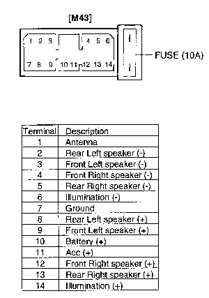

Old May 7, 2006 | 03:18 PM
Attachment 156
I scanned this awhile back, sorry I forgot to post it.
Personally, you are going the hard route. Go get the appropriate smart cables from Circuit City and be done with it in 5 minutes, no soldering, no crimping, nothing.
