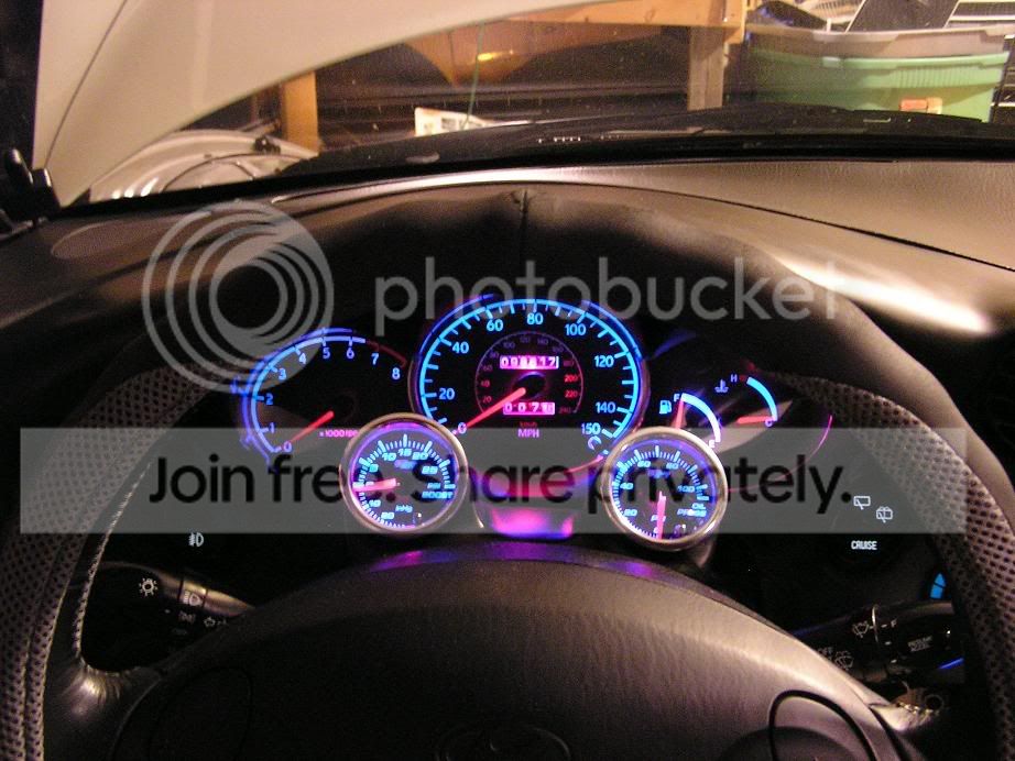

I liked how the wedge LED's from SuperbrightLEDS.com came out as well. I did modify the needles with red LED's so the needles would be bright, but even before i did that, I liked how it looked. The only drawback is your needles will probably be very dim. I did a lot of work to get the blue numbers and rings and red needles. I almost wish I would have just gotten red LED's and just did everything in red. I think if you did that, it would look great! Everyone here seems to have blue LED's, it would be cool to see someone do red or another color instead. But with some work and some patience, you can do just about anything.

Yup, my needles are dim, and they look weird. I also thought that red would have looked a lot better..
Yours look great! How did you add the red leds? Did you drill holes through the lens thingy? And how did you get those blue circles around the gauges (the left and top part of the tach and the left and right parts of the speedo)?

radu_rd2: If you know what the back of the gauges look like, you know there are those clear plastic "feet" that travel down to the bulb location. This is to direct light to the needles. Its actually very cool how they did that. Well, I cut them completely off. I got some 3mm LED's from SuperbrightLEDs.com and actually sanded them even smaller. Then I removed the clear plastic discs that the gauges are attached to, turned them over so all my work would be done on the bottom so the gauge faces would still sit flush, and figured out good locations for the LED's to sit so they would light up the needle. I believe I used about 3 per needle on the tach and MPH, the fuel and coolant gauges I used one.
Then I used a soldering gun to heat the plastic and make "trenches" for my LED's so they would sit flush. When I got them just right, I put the shaved down 3mm LED in place and used the melted plastic I removed, put it over the LED, and re-melted it with the soldering gun to fuse the red LED in the plastic. I did it this way so the LED's would have no chance of interfering with the gauges themselves. This was especially important with the speed gauge as it has your mileage ticker under there as well. I also used some of the melted plastic to fuse the wires to the underneath of the plastic as well so I didnt have wires interfering with the gauges.
i'm sure some one will have an easier way, but thats how I did it. oh, and the rings that you are seeing is the reflection off the black rounded bezel that surrounds and snaps on the front of the gauge cluster. I chromed that piece. I didnt realize that doing that would have extra benefits when i turned my lights on at night! smile.gif
