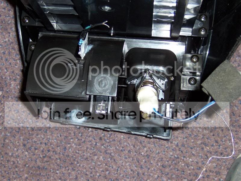

I knew exactly what you had done when I read your post. I've blown that fuse a dozen times. Also very sensitive when you're working on your head unit as well.
Old Nov 26, 2007 | 08:47 PM
^^ You need to tape up the wires on your green/white and green/black. It should not blow if the wires are covered. That means that the wires are grounding out when you move around back there.

you might be right because i did stick the legs way down there past the socket. (uugh that don't sound right) it might have scrubbed around there when i was moving it to light up.
i'm going to use a 620 resistor instead though.
