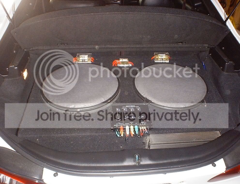

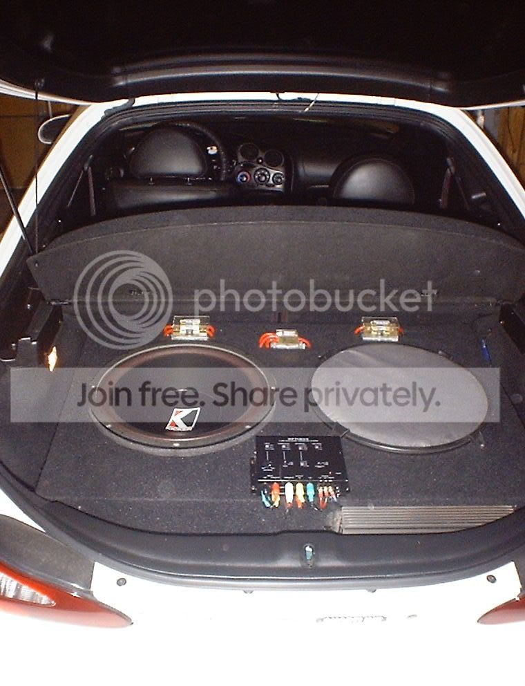

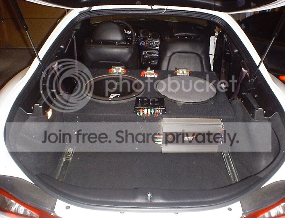

Here was my setup when I had my 15's. Amp on the outside of the box, almost all of the wiring was inside the box, so there was no mess anywhere. I made speaker covers to match the interior, They were kicker's as you can see.
I mounted the box on heaby duty drawer sliders I got at Home Depot, so when I folded the seats down, the ENTIRE box, including speakers, crossovers, wires, and amps, ALL slid over the rear seats and would give me complete access to the spare and also would allow me to haul groceries and such home in the trunk. It did wheigh alot thoug, thats why I have my 10's and am still happy with the thump. smile.gif Good luck with your setup!

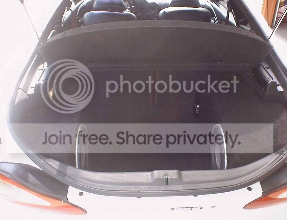

My setup as of now...

the 10's definitly look alot cleaner. but how do they sound? ive read that when you fire two subs directly at each other like that, the sound waves will cancel out each other.

They sound as good or BETTER then the 15's. The 15's were older and are not as efficient as they are now. Even today, 15's are not as efficient as a 10 or 12 in my opinion. I am sure this will get argued down the road. smile.gif
You are correct in that if the subs face each other and are TOO close, the waves will inferfere with one another. I haven't had any problems with them with the spacing that I have them installed at.
They hit 138.2db in a drag competition I did a few years ago. I only got to compete for 1.3 seconds because all I had where 60 amp fuses for the competition and I kept blowing fuses. If I had 120 amp fuse, which is what I was suppose to have in the main line back, I think I could have been around 144-146. No record breakers, but loud enough to get heard, especially with only 2 10's.
it all depends on the type of sound, as well as the difference in audio from each channel playing out of each sub, as well as how you have them ported. If you port them to the front, there should be no problem with it as you will be listening to the ports. The actual car's vibration may be cancled, but the porting will allow the sound to travel.
