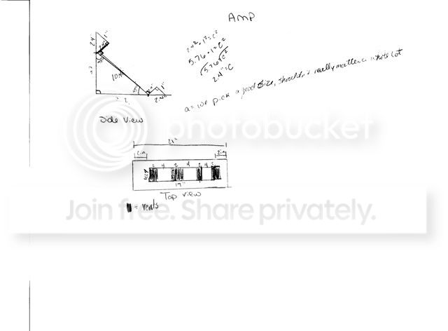

EDIT 2: while looking into the box.....we cam across a problem.... we dont know VB stands for in the manual for enclosures..... heres a pic. any ideas?

sry redz bout the pic, but it needed to be readable and i didnt know to shrink it and make it readable.
i already got a lightning audio cap, 1 fariet. also i would like u to tell me what u think of an enclosure design,
like have that pointing towards the rear, and the subs angled a little at the bottom u notice the flat edge, ill have an amp thingy that will go at the gbase and take up that space
EDIT: WTF happened to image linking! 02.gif

I think Madtib is wrong. Vb is the volume of the box (in cubic feet), Vd is the diameter of the vent, and Vl is the length of the vent.

ok thx man i researched vb and its the volume.....

Yeah, you're right.I was thinking about something else.

but mad can u check out the designs for the enclosure and tell me how u think it will react in a tib. i dont know what angling up will do but it was the idea i had....
i want to know the difference between having them at an angle or having them facing straight upwords like in the tib with 4 jl subs
hehe, i forgot....photobucket doesn like bit format
here we goo......
