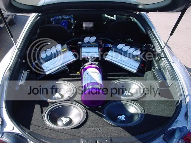

another option i think i might go with untill i know exactly what i want, i think i just need to play with setups a little more.....see what i like and dont like. anyways a setup like this pic but with only 3 10" phoenix gold titainum 10 subs
Problem with 3 subs is if they are 2 or 4 ohm.You won't be able to wire them for the correct total impeadance.Unless the amp you're going with can handle a .5 or 1ohm load, bridged.
