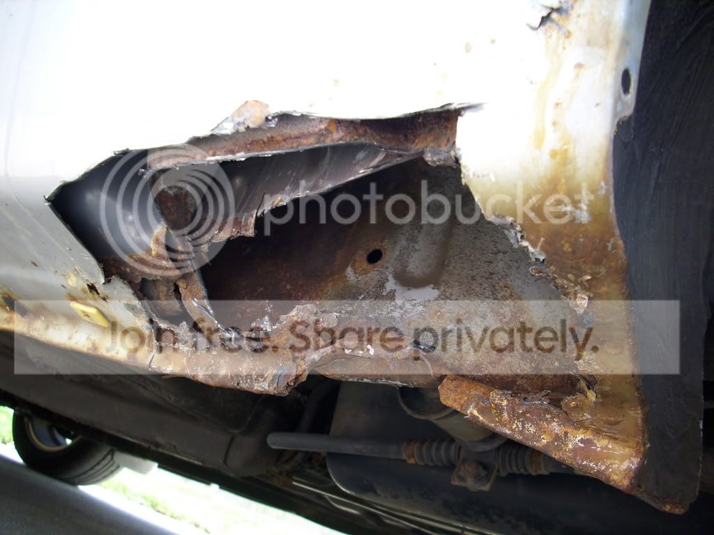

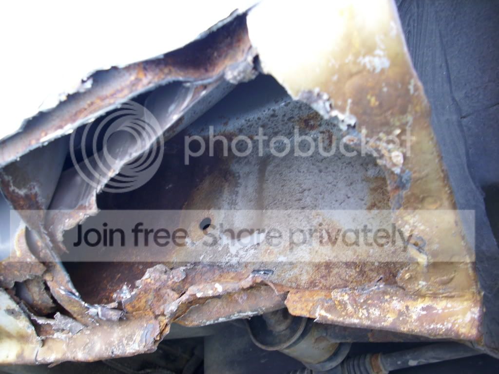

Since i started the thread ill bring more up...
I knew i had a problem with my rear quarter panel since some dumbass hit my rear wheel well over Christmas 2 years ago..
http://www.rdtiburon.com/index.php?showtop...t=0#entry339625
Found out today that its not just a dent that there is a little gap between the sheet metal and found out today im extremely lucky that it didn't hit my structural part yet.
RUST BELT SUCKS! FIND SOMETHING ELSE TO MELT ICE OFF ROADS WITH!
These pictures are whats left after taking everything that was flaky or was thin. For size refrence, you can see whats left of the jack mount. i would say its a good 4x6 hole...ALL neatly hidden behind the sideskirts.
pic posted at request of NVS.

I have the same thing I'm currently working on. Its a PITA. Very shitty design in there.

damn pinch welds and fold over seams....wouldn't it make sense to have a one piece vacuumed piece of plastic on the underside and wheel wells?

holy shit, you weren't joking over the phone were you?

I wastnt even done when i called you i was still cutting out the rust! its at least a post card size hole.. I donno what the lenth of the jack point is but you can tell its a few inches wide!
