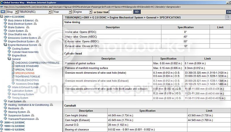

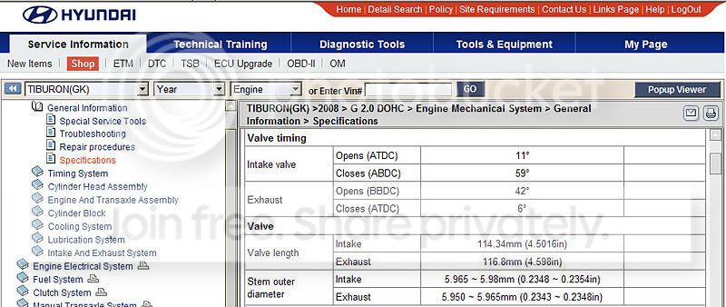

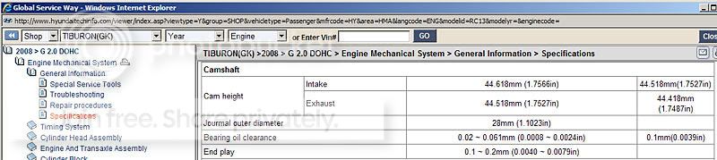

Local scrap yard has a GK engine all torn apart and they are willing to sell the cams for only $20. Does anyone have any specs on the differences between a GK and Beta cam as far as lift and duration goes? Probably wouldnt be able to use the GK cam in my car, but its more of a curiosity thing for me. Thanks.
