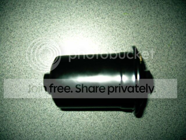

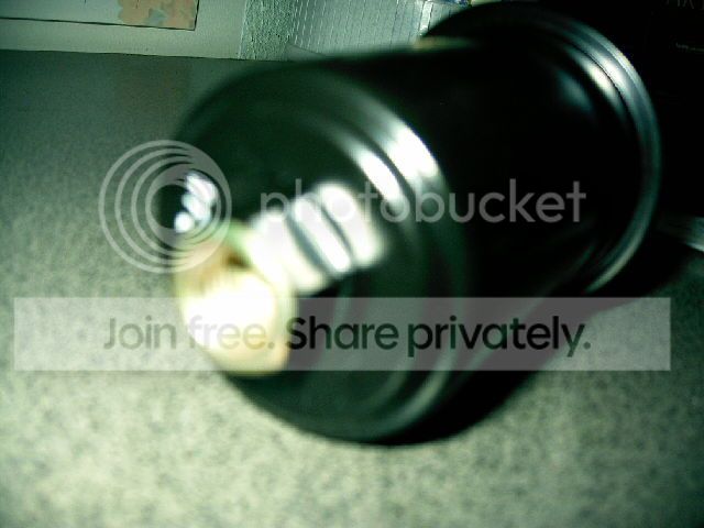

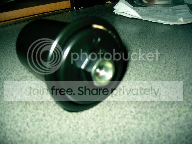

<div class='quotetop'>QUOTE (rallyman @ Sep 8 2005, 12:42 PM)</div><div class='quotemain'>The hex nut that you are showing on the new one points down when it is installed. Show us a pic of the other end of the new filter. It should look the same as the one on your car with a hole for the fuel line and one for the bolt.
You must think I don't check out it's other side?? LOL
Here's a pic to proof what I am saying.
SIDEWAYS VIEW
LEFT SIDE OF THE FILTER FROM PIC ONE ( TOP OF FILTER ) Hexagon...
RIGHT SIDE OF THE FILTER FROM PIC ONE ( BOTTOM OF FILTER ) Hexagon...
I'm heading to the dealership to ask them If monkeys grab their parts for them...

That's definitely a problem. See what the dealer has to say.
I think I paid an hours labour at the dealer to have mine changed so about $75 CDN. Not too bad to save a truckload of hassle.

yeah thats definently not the right part probably got stocked in the wrong spot.
