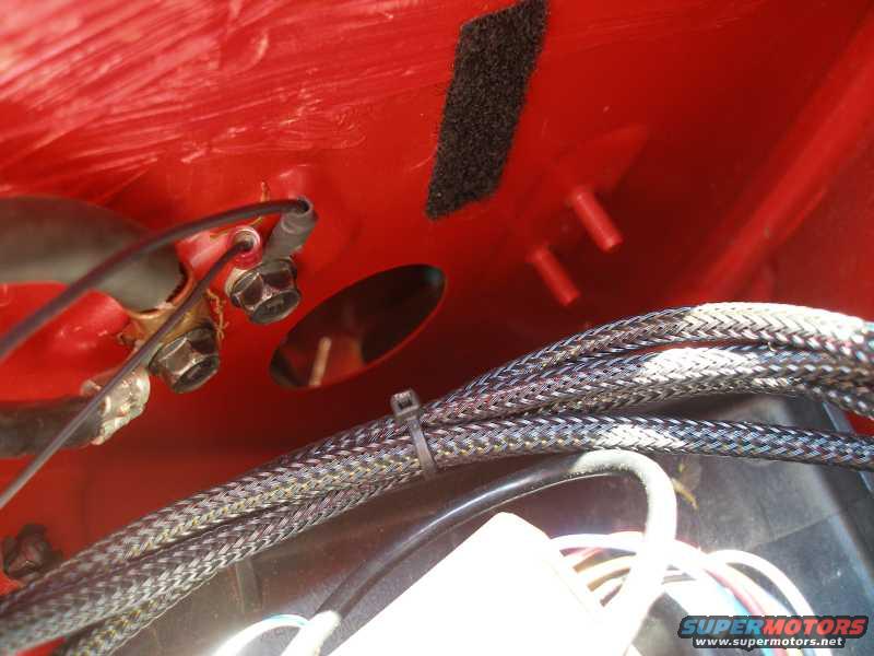

I don't know about your car, but the RD platform has a BIG hole on the inner fenderwell near the battery that lets you run wires to the firewall inside the fender, and then it's easy to use an existing penetration or make your own, to get even a pretty good size wire through the firewall.
