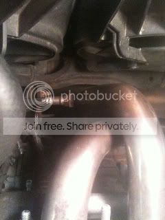

ok here is my set up if you need more pics i can get them a i still need to change something that my dumb machanic did which ill explian with my pic
here is my header with O2 sensore on side
