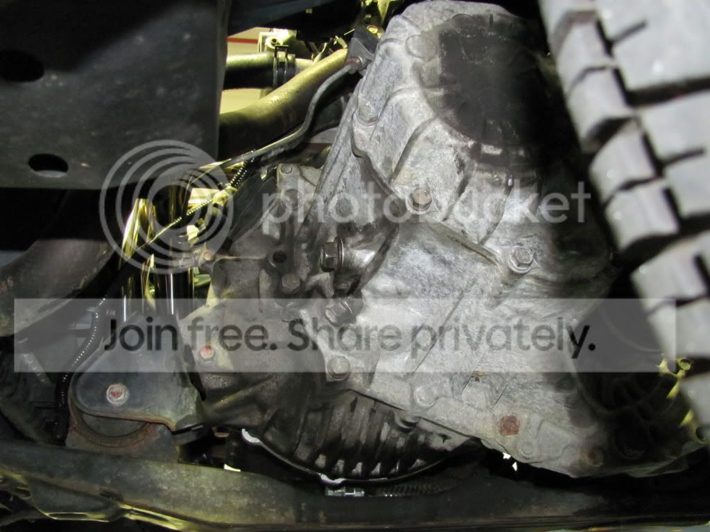

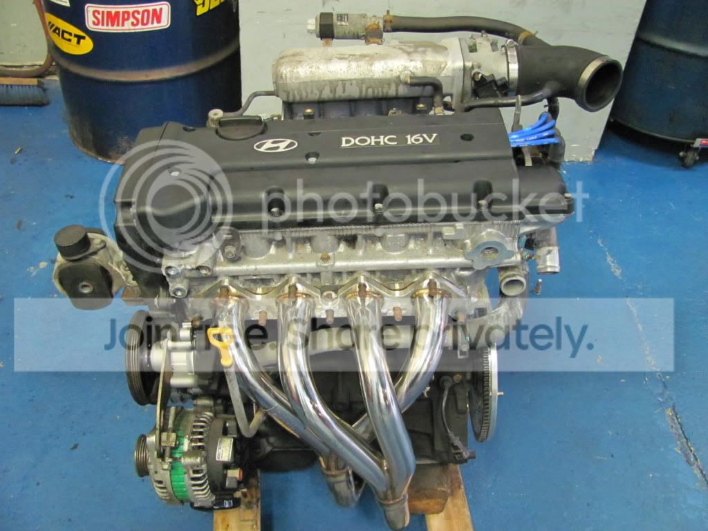

We swapped a Beta motor into a '99 Accent over the weekend. Customer decided to get a lightweight pulley, lightweight flywheel, timing service, a header and Spec Clutch. We kept the Tiburon mounts and used the Accent transmission and axles. Here are some pictures. Enjoy!

BangHead.gif ooo goshh..i want that engine..
where you get that engine? is it G4GF? how much do you spend for this engine?
how is the power output know?

That engine was sourced from a local junk yard for $140. Came with everything except the transmission.
