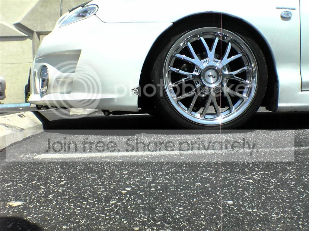

> Clearance.

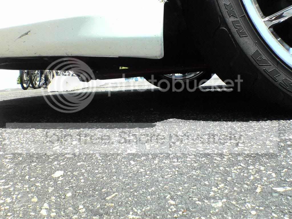

I believe currently, it would sit about as low as your body kit. It does sit slightly lower than the Cuda front bumper. As in, I look at the car from the side, eye level with it, and I can see the joint (lowest part of the bar). I need a camera... ohh! my friend is here today. Maybe I can get a picture.
Anyways, I suggested to Tom about beefing up the bracket around the joint, he thinks it's a good idea too. That way it can take a little more abuse from being hit.

> Clearance.

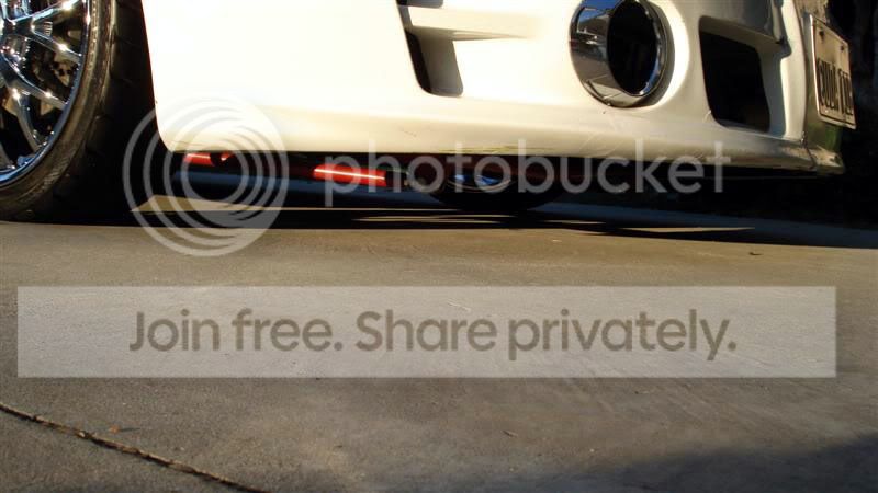

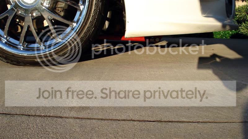

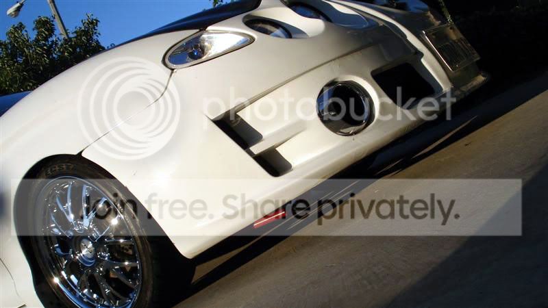

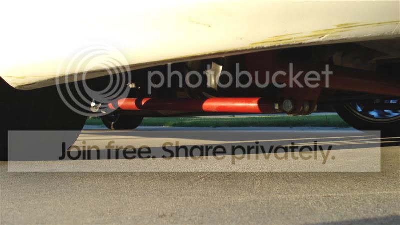

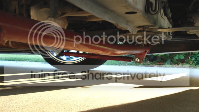

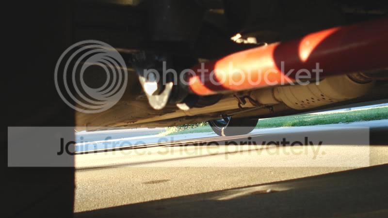

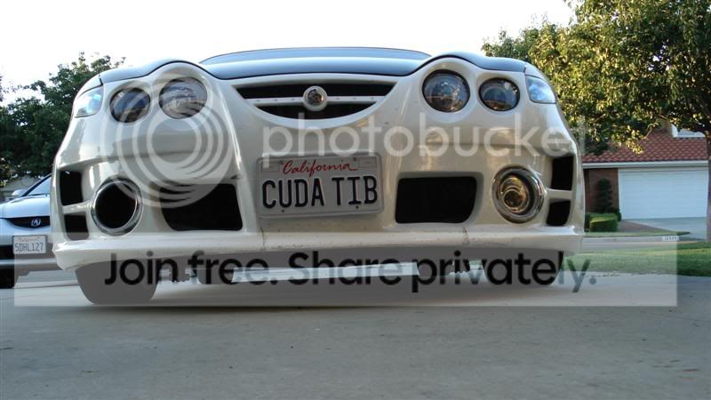

Here's some pictures. You can see where I have been scraping.... and leave my car alone, it's a daily driver.. it looks bad under the car. haha.
We were talking about raising the ends of the bar about an inch if possible. But that's what Tom is working on.

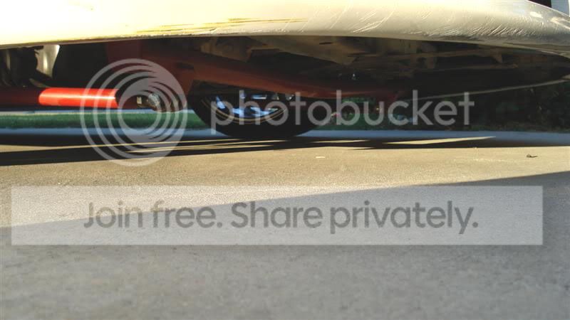

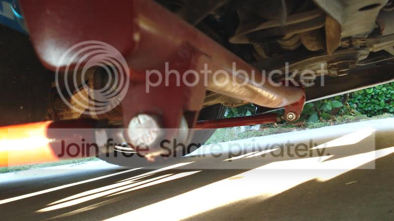

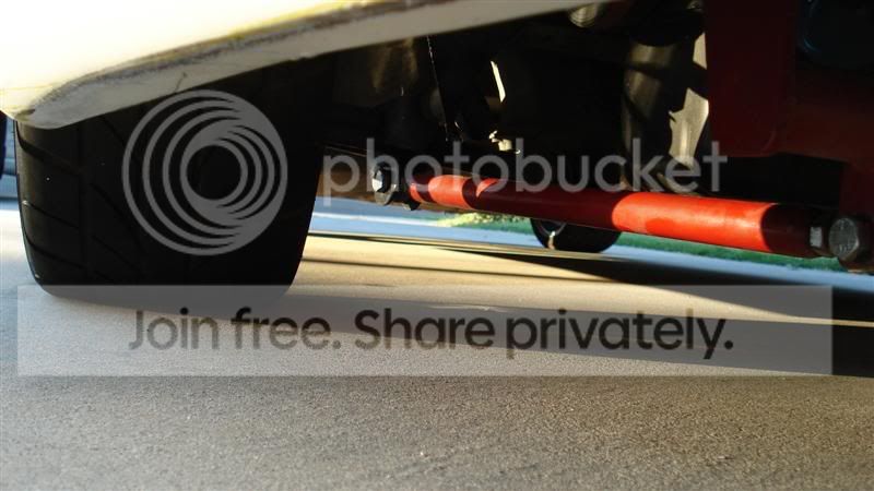

Here are a couple more photos.
Oh, for those worried about speed bumps.... I can clear speed bumps. Where I normally tag the bar is when I am going straight through and intersection with a good size dip in it.
It might look low, but it clears more stuff than you might realise. However, I do feel it does need to come up a little also. Just to make myself feel more comfortable. Tom knows all this and he's working on it, so don't worry guys!
I'll see if I can get some more pictures at random places around town.
