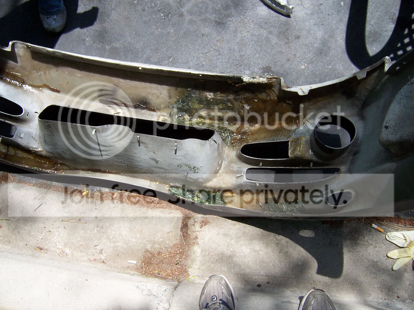

Epoxy tabs on the back. Like on my buddy's bumper. Then you can make adjustments
pic durring repair

for the mesh in my bumper and hood, i epoxied some 16 gauge wiring every 6" or so, then put the mesh in and bent the wires to hold the mesh in place.
the shop that installed my kit first used hot glue, but after a couple years it started to come off.
