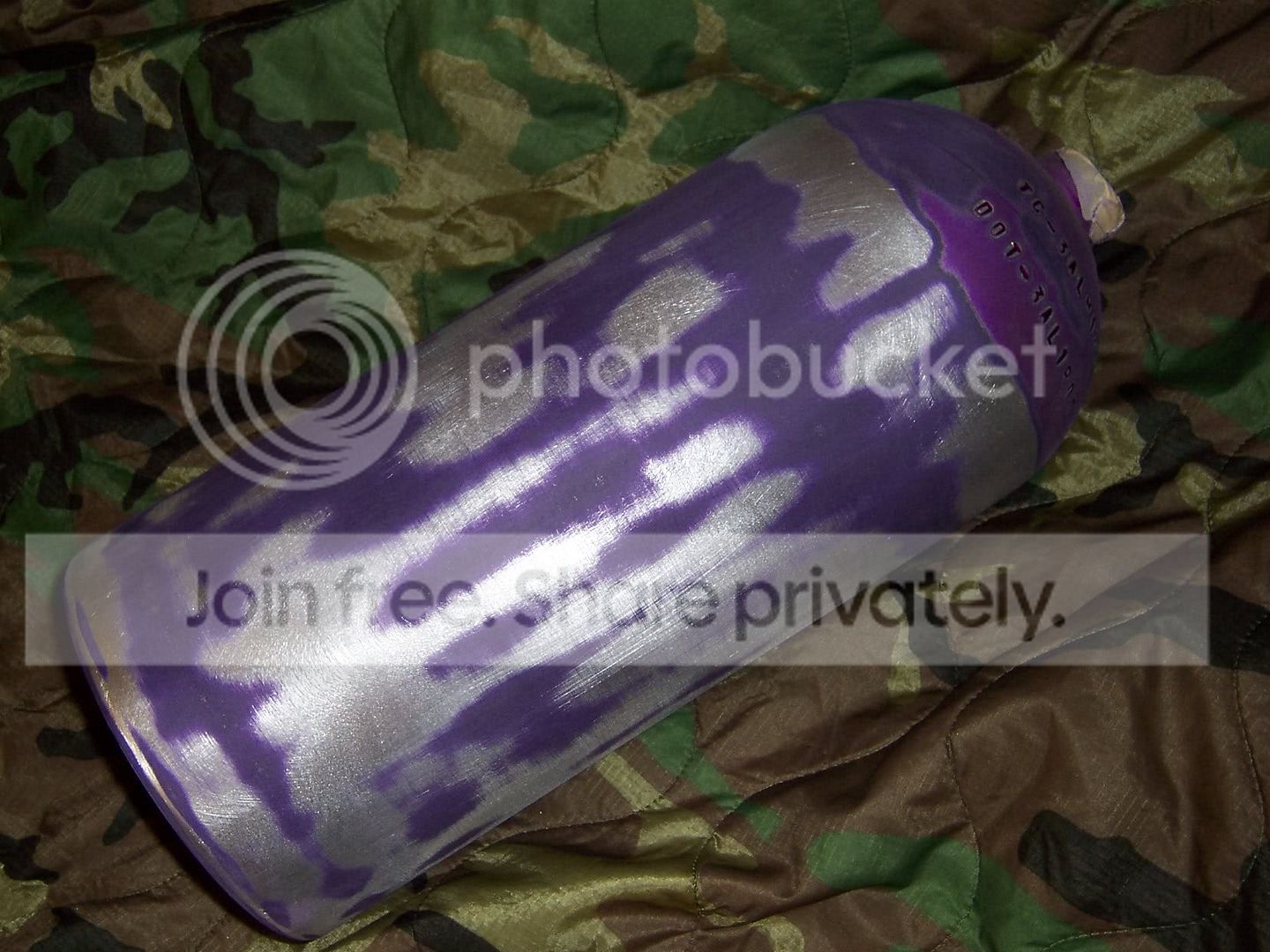

^^ Psssht. It dosn't take any skill... Just start sanding everything with 120 grit sand paper. When you start to see the primer turn into metal, move to a finer (higher number) grit of sand paper, like 220. When more metal starts showing move to 400 grit sand paper. Try not to sand into the metal too much.
This is a painting picture of my nitrous tank. It was an extremely hard and thick paint. i started with 80 until I started to see primer, moved to 120, then 220, then 400.
The picture shows all clear coat removed, some paint around the top part, some primer on the center part and the metal below. Really, that's the same as what you're going to be looking at when you sand a car, but car paint comes off easier. My picture does not look like a very pretty sanding job because i did not have the tools necessary to do a round surface by machine. I used a flat sander and it took a long time. Even if you just aim to take off all the paint and leave the primer, it would be better for adhesion then painting over clear coat.
It's really about how much patience and strength you have in your hands. Don't sand plastics, rubber, or windows. You know, things you don't want painted. Get a few friends to help.
The first part of my car I ever sanded was the dashboard. It was really wierd. But then I realized it was all part of a process. It's gotta look bad before it looks good.It takes balls to sand your car if you're not a body shop guy. That's unquestionable. But really, it's a simple mindless task and hard to mess up.

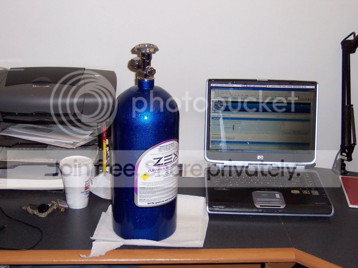

Now I feel bad for posting that nasty looking sanded picture. Here's the final product using nothing but spray cans.
That's dry paint, no rubbing or polishing on it.
