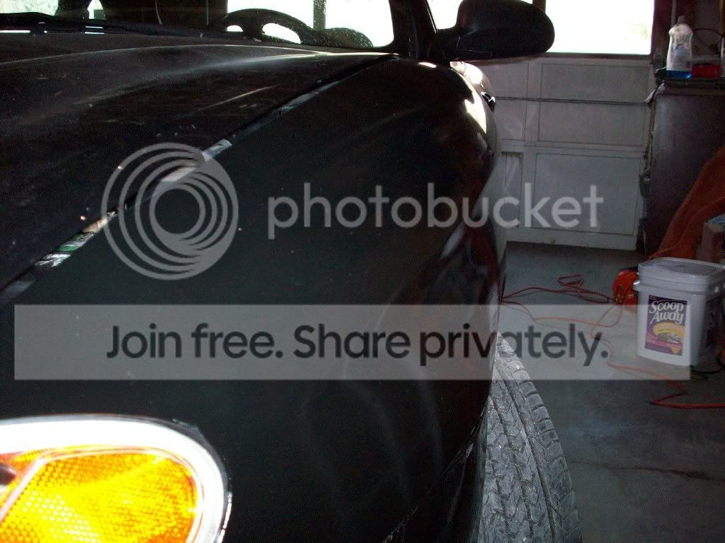

Tell me what you think!
honest criticism is appreciated.
Old Apr 24, 2008 | 08:57 PM
Jason's Avatar
Posts: 278
Looks pretty good.
But it's kinda hard to tell with the pics...
Old Apr 24, 2008 | 09:02 PM
Nex's Avatar
Nex
Joined: Mar 2007
Posts: 409
From: Pembroke Pines, FL
i concur with Jason, take pics outside with the light of the sun.
the sunlight never lies about color tones.
but as far as i can see, looks like you did a pretty good job

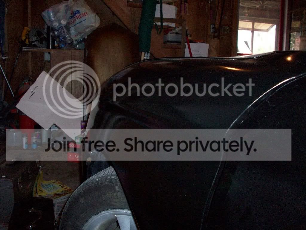

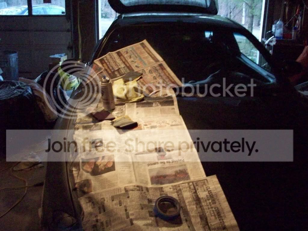

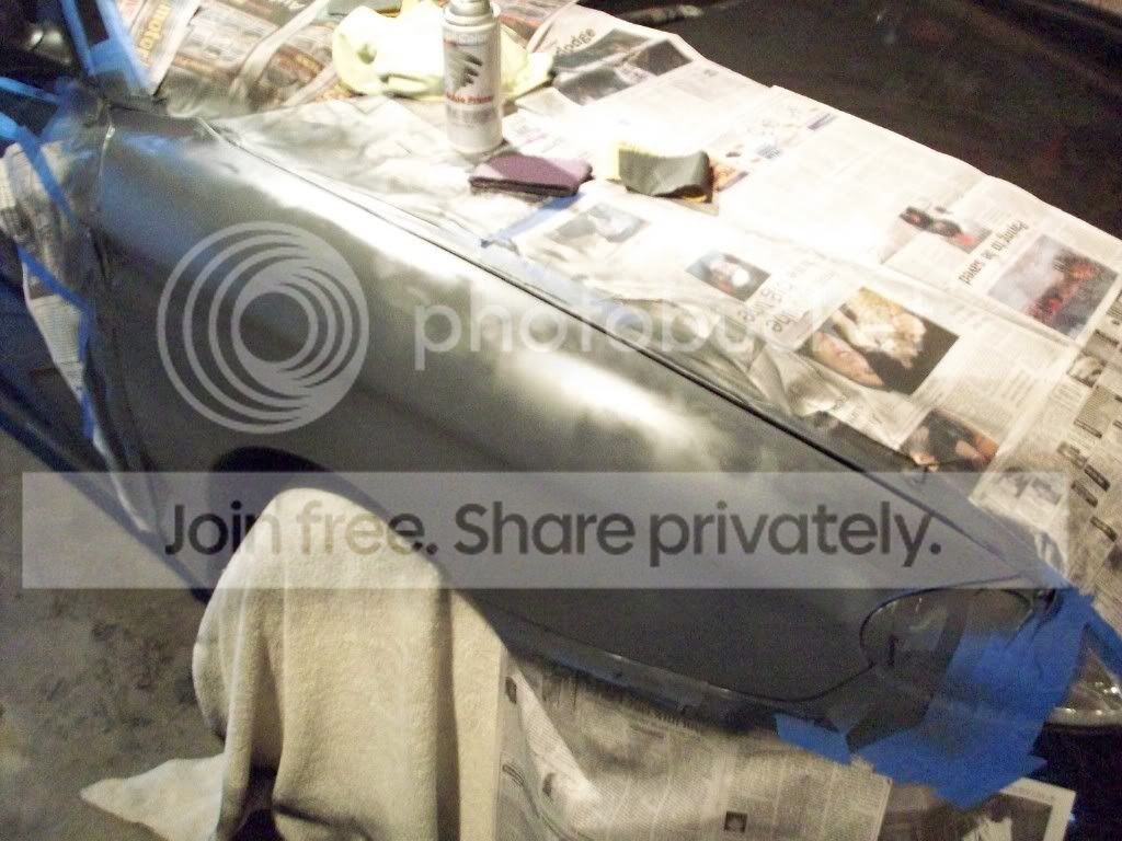

sunlight pics are coming soon, i needa finish the rest of the car fist.
I have another fender to do, plus i needa do a bunch of touch up, and of course wax!
this is how my car looks right now
and the other fender
hopefully finished by next week.
Old Apr 24, 2008 | 09:50 PM
StrikeEagle's Avatar
Posts: 2,881
From: Huntsville, AL
Dude, that's gotta be the hardest way to paint fenders!! Take it off the car!1! It eliminates all risk of overspray, and there's no need to mask anything off. Removing your fenders is the easiest body part to do. Take out the corner light (1 screw), remove 1 nut in there, then take off the 3 in the engine bay, 2 behind the bumper, 1 that you see when you open your door, 1-2 in the wheel well and 3 down by the mudguard. I had mine off in about 5 min, and back on in 10. Just put it back on today, in fact...
But definitely get that thing off, it will save you such a hassle.
Old Apr 24, 2008 | 10:29 PM
ThisCelluloidDream's Avatar
Joined: Apr 2008
Posts: 126
From: North Adams, MA
yea i removed the other one to paint it, but i talked to my friend before i topcoated it who owns a bodyshop and he said i should put it back on and tape it up to finish it, it cuts down on the risk of chipping the paint ( i chipped the paint in about 15 places putting the fender back on) after that i topcoated it and clearcoated it. so im doing everything from primer on up riht on the car this time. made my life a little easier :]
