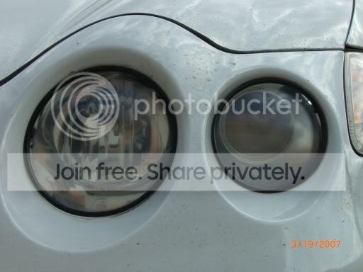

I just bought this on eBay this past Saturday. What tibbytib suggests is more convincing though; I'll try it if this cleaning stuff doesn't work.
I'll let you guys now how it comes out as soon as I get this stuff in my hands..

This ebay product does work. Look at the results.
I took this picture after cleaning them
It didn't came out crystal clear, but it's clear enough to make me happy smile.gif
I might try the sanding paper with Plast-X method next month though.

Wow, that looks really good!! I'm glad you got it to work!

wow, your before pic's look horrible, what would make the lights get that bad in the first place? mine are still spotless and perfectly clear, and i rarely clean it throughout the entire winter.

they are being like that since i bought the car, i'm just lazy, but when i decided to buy hids that's when i decided to clean them, tongue.gif
in fact, in this mere moment my hids are in their way home. jejeje smile.gif
