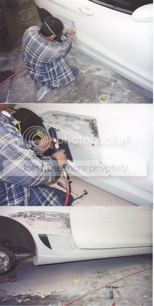

Two screws won't be enough mang. Does it work? Yes. Does it hold? Yes... but will it last in the long run? No. I think I posted a picture before.. gimmie a sec
You want to do multiple screws along the side for duability and longetivity. Where two screws will hold, multiple points will make sure the skirt never tries to pull away from the body and possibly cracking your bondo work.
I think I have about 25 screws per sideskirt holding it on.

After having everything molded, I thought about something. If I were to jack the car up at one jack point in each corner, is that enough stress to crack the seam? I imagine that the car stresses in weird ways when jacked up at a corner, but is it enough to mess with the molded skirt? Spiffy? I guess I need to find out how many screws were used to bolt the skirt to the car before the mud.

Well, it could crack. I just went overboard with the screws so basically it would never crack. Yeah, stress on a corner and twisting the car could potentially crack the side skirt molding. Also landing on something like a speed bump (which I have done) can crack the molding. (Although I've landed the car on the couple speed bumps and never had a problem.
See Proen, Import Trendz man. smile.gif Yeah, the front might need a little work. But that's how low cost Fiberglass stuff is. Yeah, once you mold in the sides, you won't be able to get the grill inserts out.
