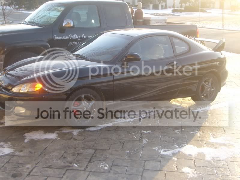

I'm looking so forward to getting this kit. I love it so much. The only downfall is the dual exhaust factor (WHY DID THEY PUT THAT THERE?!?!?!????!??????) and the fact that they make no dual for our car, on that note, will a GK exhaust fit an RD? Also, I don't think my KDM shark spoiler will match the cuda all too well.. This is my car as of now.
And I just love this pic for some reason! lol
