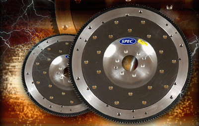

What I said in the Shoutbox is that that blury picture DOES say SPEC on it. I see it even though it's blurry. The XTD sticker is the same shape, and I think size, as the spec sticker.
I'm trying to do some research on them in the background, but it seems everyone under 250 WHP is happy with them, and everyone over it hates them with a passion.
